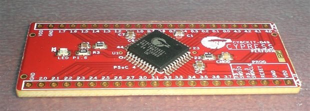

This week I've devoted all my free time to the project, to complete its programming part.
So this week I've done the following:
  • connected indication led (now - RGB, in a future - 3 independent leds);
  • connected avionics (IMU): Gyro - L3G4200D, Accelerometer - ADXL345;
  • PID-regulators, complimentary filter etc.
Now my stand looks like this:
New components:
  1. Gyro L3G4200D
  2. Accelerometer ADXL345
Let's look at the final PSoC schematics:
Red-module consists of 3 leds:
  • stablePin = red led: ON - horizon hold mode, OFF - acrobatic mode;
  • buzzerPin = green led: BLINK in some service functions (gyro-calibration, EEPROM write, etc);
  • ledPin = blue led: ON - armed mode (propellers are spining), OFF - disarmed mode (propellers are stoped).

Now, I encountered a small problem, I have no special programmer for PSoC and I have to get out somehow to flash a single microcontroller. However, no sooner than I thought about this,  Gagan sent me a gift! Thank you very much, now No need now to make PCB for experiments, that  will accelerate considerably the development!
