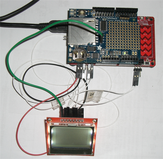

This the primary target was to make the wake-up using watch dog timer work and have the Nokia LCD working.
Still need to implement the Fonts to draw on the screen. Quick snapshot of the current design:

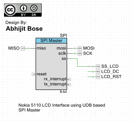

SPI Interface - Which one ? : Issue 3 - Detail
The Nokia 5110 works on SPI interface + few GPIO to control the communications. On the Pioneer Kit there are 3 possibilities of SPI configuration in terms of the Pins available.
One can use the SCB based interface using the SCB1 on P3.0-P3.1 or SCB0 on P4.0-P4.1. Other wise the UDB based SPI master where arbitrary pins can be used.
Now the question is which one would be most optimal to choose from. In case of DAS the SPI is needed for two purposes - Nokia 5110 LED Interface and the SD Card interface.
The best Selection of pins based on the PMOD connector on the Pioneer Kit and the SPI pin mapping for Arduino Shield was as follows:
P3.0 - MOSI
P3.1 - MISO
P0.6 - SCK
P3.4,P3.5 - Slave select lines.
Well PSoC4 is very configuration chip but there was small short coming from the SCB based SPI interface while using these pins.
The SCB1 in SPI Master mode interface expects that first slave select pin SS0 must be routed.
On the Pioneer Kit this pin is P0.7, that's the User Button. Now if accidentally this gets pressed then the SS0 line would be short directly to GND.
This is potentially fatal for the board. Additionally unlike the UDB blocks one cant keep the SS output not connected.
Hence the only choice was to use the UDB based SPI Master. The SS pin can now safely be routed to the desired location.
Next comes the use of the same module for the SD card interface. In order to do so we would need a Nand gate at the SS output of the UDB based SPI module.
Using an Control Register this can be optionally enabled or disabled along with another pin for the SD card slave select.
