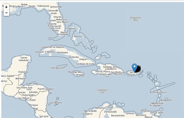

A few posts ago I plotted a map with the coordinates from the PSoC manually by creating a Google Docs Fusion table. Last night I finished a small script that post the data and a page to display the data.
The web part has three major components:
1. The web app (using Django, python)
2. The Rest Api (using Django rest framework, python )
3. Plotting the map (using Leaflet, javascript - using open street map data)
Oh and since it is in python you may run it anywhere, on your pc or on you Raspberry pi.
All code is on github, I commit as I go so it is not close to be organized but is on the line (online!).
Reads from PSoC into a text file
https://github.com/soynerdito/psoctracker/blob/master/test/import_bluetooth.py
Reads text file and sends it to the database
https://github.com/soynerdito/psoctracker/blob/master/test/gps_post.py
Here is a picture of the data I posted. In this example there are plenty of dots but all are close together because they were taken while I was programming with the GPS out the window. But you get the idea. Also for who didn't knew where Puerto Rico is, now you know. Boom!, extra info right there.
