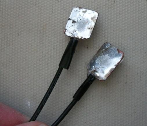

Here I am with my third update on my brainwaves based appliance controller project.  Things started to be harder and harder: after getting enough familiar with PSoC Creator and building a few small applications (that was fun!) I felt that I need to start looking into how I will measure brain waves. This is probably the most difficult part of my project, so I spent a lot of time reading and then I built my first set of sensors as shown in the figure below.
These are called passive sensors and are applied directly to the skin (usually using a conductive gel in between, but I try to avoid this if I can make them work without gel).

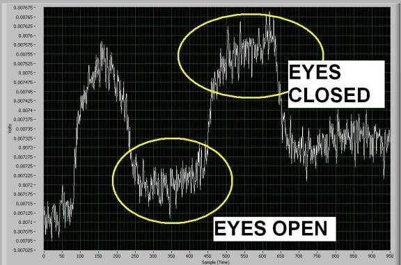

Measurements showed a lot of noise but I was able to sense when I closed and opened my eyes, as I show in the screenshot below.

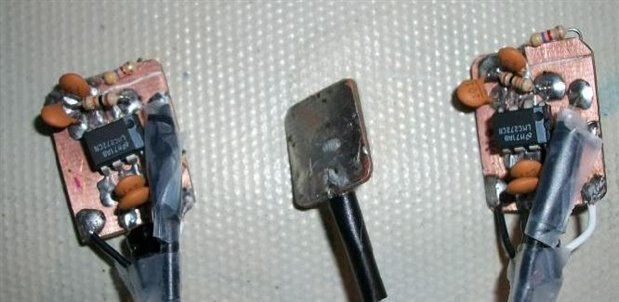

Further analysis of brain waves did not distinguish any other type of brain waves, so I decided to improve my sensors by adding an amplifier.  The second set of sensors that are now called active sensors are shown in the picture below:

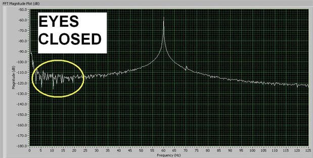

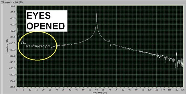

With these sensors I was able to measure a combination of alpha (~8-12Hz) signals on the occipital part of the head, as you can see in the FFT screenshot below.
The signals are still hard to extract out of noise so I don’t know how I will be able to distinguish among various types of brainwaves and then to use them to control appliances.  This is a hard challenge for which I do not have a solution yet.   So this is where I am now; basically the measurement of brain waves remains still a challenge and this is what I will be focussing on next.

    - you could consider having the PSoC 4 in the sensor itself, that way you could get rid of the amplifier you have in each sensor by using PSoC 4's Opamps. maybe helps with splitting the processing across 2 devices as well.
