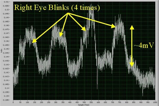

For #2, I looked at many possibilities: EEG sensors placed throughout the scalp need gel and need special preparation of the skin (they are like little needles that are pushed into the skin).  I think these electrodes may work if applied correctly but I don’t see them so practical from an appliance control product perspective.  Another alternative would be electrodes that can be pressed against the scalp using an elastic cap but they also need some gel to insure low impedance to the skin.  These types of electrodes are easier to implement in this product but I still think that they are somehow inconvenient to use.  After I investigated a few other types of electrodes I decided to use dry electrodes applied on the forehead.  The main advantage of this choice is that there is no hair so I can use metallic electrodes applied directly to the skin.  There will be 6 electrodes placed in a row just above the eyebrows.  In the picture below I am wearing three electrodes above the left eye; this is an experiment setup – the following version will have another three electrodes placed above the right eye.
For #3, I have measured various signals with these three electrodes, and so far I see a few possibilities of signals that I can use for controlling appliances:

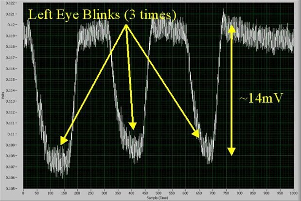

Selective blinking of one eye – each group of three electrodes can pick up the electric signals associated to eye blinking.  Below I am showing the right-eye blinking compared to the left-eye blinking.  It can be noticed that the three electrodes that I am wearing above the left eye can differentiate which eye I am blinking: left-eye signal has an amplitude of about 14mV while right-eye blinking signals have an amplitude of about 4mV.  An identical group of electrodes that I will place above the right eye will measure higher amplitude on the right-eye blinking than on the left-eye blinking.

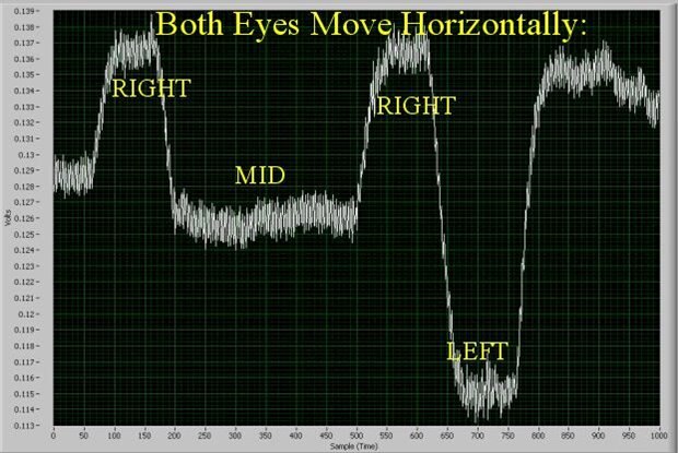

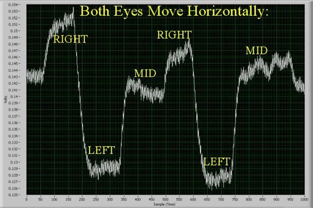

Eye movement – I was able to measure the horizontal movement of both eyes, and I could differentiate the direction of moving from the polarity of the measured pulse.  Here are some examples; when I move the eyes towards the left side I measure a negative pulse and when I move the eyes towards the right side I measure a positive pulse.

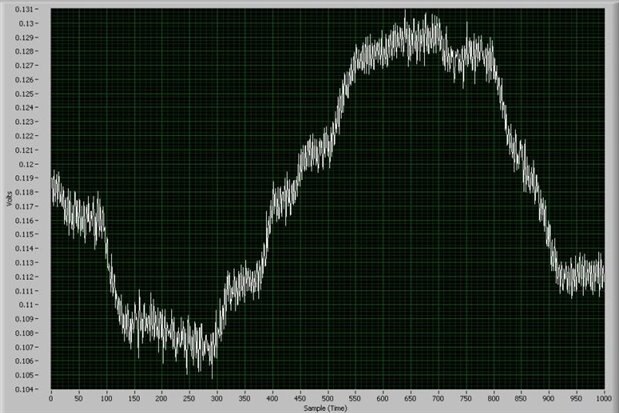

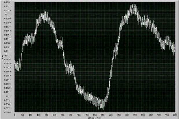

Eye rotating – if I rotate the eyes slowly a full circumference I measure a signal that looks like a sinusoid.  The direction of rotation, clockwise or counter-clock wise, determines the polarity of the “sinusoidal” signal.  Here are two pictures showing the signals I measured for both rotation directions:
Clockwise rotation of both eyes:
Counter clockwise rotation of both eyes:

    Cool to see your progress, I like the illustrations, both the photo as the LabView plots.
    EEG is very difficult, also to correlate which signal "means" what (almost everything should be statistically tested to get no false postives / negatives). Wise choice to use eye muscles.
    One question: would it have been possible to use the opamps in the PSOC for the amplifiers you're making (except for their physical distance from the electrode)?
