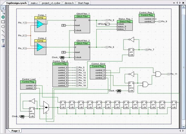

Here is a screenshot of the entire system as implemented into the PSoC4 chip on the Pioneer kit:
The long chain of flip-flops is my shift register since I ran out of UDBs ( 2 hold the glitch filters, and the other two the registers).  So after being a little disappointed when I've got the error message pointing to my PSoC4 shift register block resource availability I then tried to "trick" the chip by creating a "home made" shift register and I was happy to see that it worked.

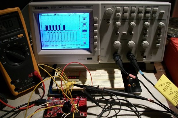

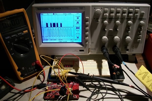

And below I am showing a few examples of data encoding.  The picture below shows the Manchester encoding four signals corresponding to sequential eyes movement four times to the left (and back to the center).  The encoded signal as stored in a register inside the CPU can be seen on the LED bar graph (on the breadboard).  Then the modulated signal transmitted serially through one pin of PSoC4 chip is captured by the oscilloscope (upper trace).  The lower trace shows the clock that controls the shift register.  In these experiments below I used a much lower frequency for validation/troubleshooting purposes.  There is a start bit and an end bit, and in between there are the four Manchester encoded bits corresponding to the eyes movement described above:

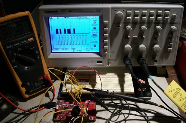

The following picture shows the same type of example but this time for a sequence of eye movement: right -> center -> right -> center -> left -> center -> left -> center
And one more example for a sequence of eye movement: left -> center -> right -> center -> right -> center -> left -> center.
