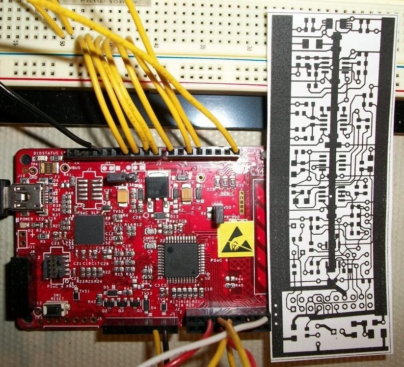

This weekend I spent some time finalizing the front-end amplifier PCB design and I submitted it for fabrication. I have designed this PCB to be plugged into J2 connector of the PSoC4 Pioneer kit, and below I am showing a picture of a printout of the PCB layout next to J2 connector:
I expect to receive the bare board before the end of the week and some parts on back order are also due this week, so if everything goes right next weekend I will assemble the board the test the entire brainwave appliance control system.

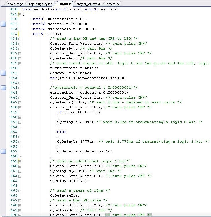

After submitting this PCB for fabrication, I went back to IR remote control protocols and after a few hours of experimenting I've got the TV on/off function to work.  The main issue I struggled with was the pulse length of modulated infrared signals that I generate with a function implemented in the PSoC4 CPU.  After poking around and scrambling my mind to figure out why the code was not recognized by the TV, I found out that the pulse length of “1” and “0” bits is critical to the infrared receiver inside the TV.  So first I have recorded the ON/OFF binary sequence of bits using the infrared receiver I talked about last week; the sequence is:
000001101111100111000000001111111
The main issue with this sequence of bits is that there are 33 of them; if they were 32 it would have been easy because I could store it into a uint32 type variable, but being 33 I couldn't fit in.  I then went back to my old C and C++ books and I tried to define a 64 bit variable as long long and unsigned long long, but the compiler didn't like that and complained that the length does not fit into the variable type that I have chosen.  It looked to me that the compiler ignored the first “long” term in the definition and thought that I define a variable as only “long” type (I think it happened like this from the error message that I received).
What really helped me was to notice that all codes of the various functions on my TV remote have the LSB bit equal to “1”.  So I then modified the serial bit transmission function so that I send a “1” bit at the end of the 32-bit sequence, thus making possible the transmission of 33 bits while storing the code in a 32-bit variable.
Trying to solve this issue I then figured out that the sequence of serial bits that I showed above was actually sent starting with the MSB bit not with the LSB, which made me store this code value “backwards” in a hex type variable (since otherwise the leading zeroes would have been ignored and lost from serial transmission).
Another small challenge was the insertion of delay segments in the CPU code; previously I used the command CyDelay(…) but I had issues getting fine resolution of delay periods.  After some search on the Internet I found out that I can use the command CyDelayUs(…) which then gave me higher resolution and this way I could “fine” adjust the infrared pulse widths to be recognized by the TV receiver.
Here is a section of the code showing the use of CyDelayUs() function and also showing the trick of sending an additional “1” pulse at the end of the serial bit sequence.
