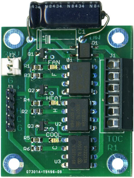

Design Criteria and Features
The Henrietta Project includes standard environmental control outputs for controlling a furnace, a fan and an air conditioner.
  • Standard furnace controllers operate on 24Vac, so the outputs must be 24 Vac.
  • Standard home controllers use the following connection format, so this is what the Henrietta output connector on the thermostat interface provides:
Signal
Colour
Function
G
Green
Fan (switched 24Vac)
W
White
Heat (switched 24Vac)
C
Black
24 Vac Common
Y
Yellow
Air Conditioner (switched 24Vac)
R
Red
24Vac Power
Rc
Red
24Vac Cooling Power
  • To ensure the 24 Vac is isolated from the digital logic the outputs are optically isolated and use screw terminals to connect to the house thermostat wiring.
  • To switch 24 Vac, opto-isolated triacs are used. These solid state devices do not wear out or make clicking noises like electro-mechanical relays.
  • To ensure the optical interface does not load the PSoC4, logic level FETs are used to drive the opto-isolation LEDs. These input signals are connected on a 5 pin 0.1" header which is the standard pitch used for all other modules in the system.
  • Outputs are indicated with visible LEDs, one on each of the 3 signals
  • To avoid using a separate power supply for the PSoC4 and sensors, the 24 Vac power is rectified on this interface card and passed on to a DC-DC converter which supplies low voltage power to the rest of the Henrietta system. Standard controllers use a similar technique. The high voltage DC is brought out to a 2 pin connector which also uses 0.1" pitch, but it has a keyed latch to provide a secure connection and prevent reverse polarity connection.
TOC = Thermostat Optical Controllerimage
Implementation
The opto interface card was designed using Eagle Cad and fabricated using iMall (ITEAD Studio). Cost was less than $15 for 10 cards, including shipping. Total cost of a single assembled circuit card is about $7. I did not have the ideal LED colours in stock, so I just used all red LEDs. However, the Pioneer Kit does display the correct colour LED(s) for each signal.

The opto interface card works well with no modifications.
