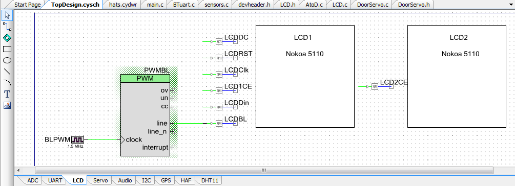

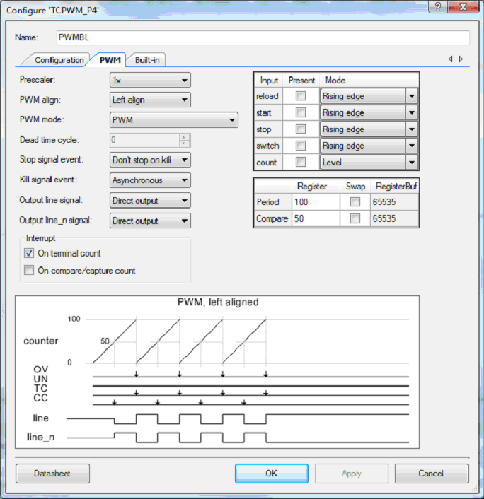

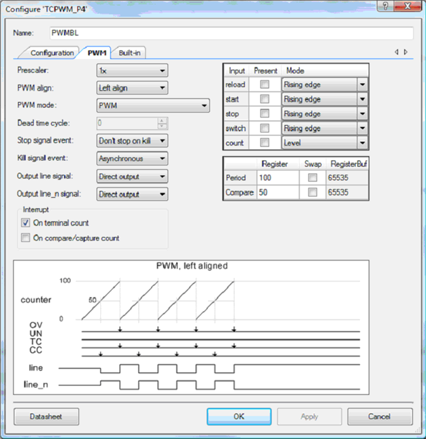

The LCD backlight LEDs take about 48 mA, which is too much for a digital output from the PSoC4, so they are driven by a PNP transistor mounted on the back of one of the LCDs. This transistor is in turn driven by a pulse-width-modulated (PWM) output from the PSoC4.

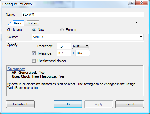

PWM is very easy to set up in PSoC Creator - these are the relevant screenshots.
