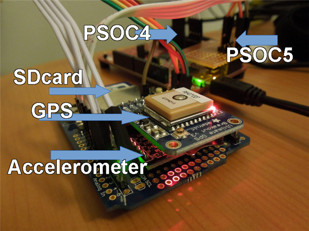

First happy weekend for all, hope it was a great one. Now the nerd update details. I have been working on my project as much as I can. Now I have added the accelerometer (MMA7361) to the project. The accelerometer is connected to the PSoC4 as analog to digital by using three wires X,Y and Z. The PSoC4 will be sending the data from the accelerometer to the PSoC5 for SDCard logging.
Here is a picture to show how it looks like (on my "lab"). It says PSoC5 showing the connections to the PSoC5 (color wires). The accelerometer wires are gray closer to the cammera, the other gray wire set are just power and ground.

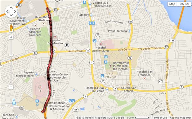

I just added the accelerometer, but the GPS been on for a while. So I was able to log all my driving this weekend with the GPS. For that I put all the hardware in a plastic project box under the drivers seat and ran a GPS cable+antena all the way to the trunk where it was held by using a magnet to the top of the trunk. The GPS data was recorded to the SDCard every 5 seconds (while the car was ON). For power it was plugged in to a standard lighter usb adapter, so no user interaction once it was installed. Whenever you started up the car it records data to the SDCard. For all weekend it created a file of 401KB of data which is not bad at all, the SDCard can hold up to 2GB so there is plenty of space to write.
Just for testing I plotted the coordinates on a Fusion table on google drive so I can visually confirm the data.
I filtered the GPS data and just plotted just a small part of highway driving. (this is at San Juan, Puerto Rico. you should come a visit some time!)
