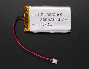

Battery and charging
I've decided to go down the route of a non-serviceable rechargeable battery, originally I was thinking I wanted it both ways (ie. have the option for the user to use standard primary batteries eg. AAA akalines) for flexibility. But for sake of keeping the mechanical requirements simpler, and having a predictable battery characterisation I've decided to use a single LiPo cell, probably 1200mAHr, something like this one:
Which is about 35 by 65mm, I'd probably find something slimmer and longer for the final product, but this battery paired with ubiquitous 'USB' charging will be the first stop. My primary candidate for charge control is the Microchip MCP73833, a linear lithium charger (http://www.microchip.com/wwwproducts/Devices.aspx?dDocName=en027785), I'll use IO on the Psoc4 to monitor it's status, the presence of USB voltage, and of course the battery voltage itself (for low battery warnings, and LED drive modification to keep a consistent light output throughout the discharge cycle).

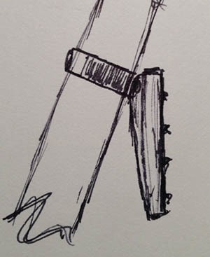

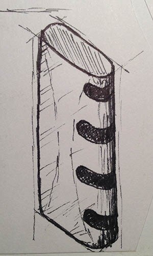

Mechanicals
I know this is a bit out of the scope of the competition, but here are some initial ideas I had for how the light might look and be attached to the bike:
