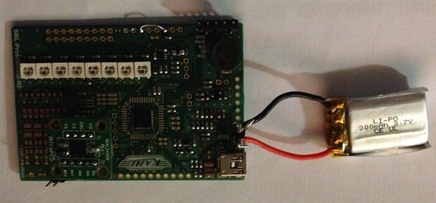

I've tried throughout to extend the simplicity of what is essentially a bike light you can forget about down to the nitty-gritty of implementation. This meant minimising hardware componentry where possible (a good example of this was ditching the body touch sense in favour of a mechanical tap gesture for user input), and making the most of the Psoc architecture to keep lines of code (at least ones that aren't auto-generated..) to as low a count as possible. The result of which is well on the way to meeting the original spec, with some nice additions along the way (the 'free' low-overhead kind, not the scope-creep-kinda-too-late-but-will-do-it-anyway kind).
Status
As it stands I have code that is in my mind ~90% production ready running on a stand-alone target board that 100% represents the production electronic design schematically. It will currently:
- Turn on when it's dark, mounted to the bike and movement is detected, making a sounds when it does so
- Turn on manually when the body of the light is tapped twice (like a double click on a mouse)
- Turn off after a period of no movement, light or when removed from the bike, making a sound when it does so
- Flash in a number of different modes (fast, slow, glow, alternating colour, rainbow, solid)
- Change and store flash modes when the light is on and the body of the light is tapped twice
- Change it's primary colour based on orientation, white when horizontal (mounted on handlebars), red when vertical (mounted on seatpost)
- Charge it's battery when connected to a USB port or charger, and indicate charge level on the LEDs
- Audibly alert the user to a low battery when it turns on
Future
In the coming weeks I plan to get to work on bedding down the mechanical design, enough so at least I can build some mockups/samples from prints. If all goes well I may then look to crowd sourcing a production batch, obviously this is not as simple as it sounds and there are many things to be considered for that to come off. But working towards putting together a pitch is a good way to continue. Beyond that there may be a spin of production electronics of a given form factor (probably ~ the size of the battery in the pic above) and testability, testing, sourcing, specifying, tooling, testing, testing, compliancing, testing and producing...
