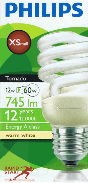

Back to the subject … Let’s say that we want to save some money on electric bills by buying energy saving bulbs. Checking what I can buy on Internet I got this data (warm write bulbs, E27 screw-in type, 230V mains):
CFL:
PHILIPS – 12W – 10k switches – 10k h work – 745 lm – $3

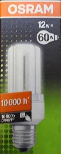

OSRAM – 12W – 10k switches – 10k h work – 660 lm – $3

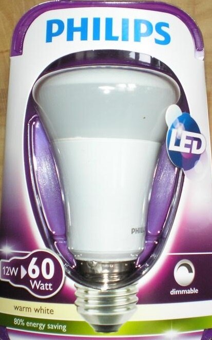

LED:
PHILIPS – 12W – 100k switches – 20k h work – 803 lm – $17

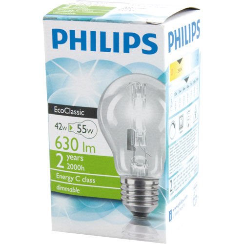

HALOGEN (just for comparison):
PHILIPS – 42W – 2k h work – 630 lm – $2
Hmm … wait a second. For the same 12W power and only about 100 lm light power more we have to pay $17 instead of $3? Right, but you get twice more h of work and ten times more switch on/offs. OK, but for $17 LED we can buy 6 or 7 (bulk price) CFLs and we get 60-70 h of work. There has to be something more to convince me for buying LED bulbs, don’t you agree?
And there are. First of all, CFLs include the mercury element. Even if you do not care about environment, mercury is dangerous for you and your family when the bulb breaks. Also, I use CFLs and their disadvantage is start time and time that they need reach the 100% light level. Usually, it is much more than a minute. For me it is just annoying. Third thing is that you cannot dim them – I mean that cheap ones. You can buy dimmable CFLs but the price is higher; around $20. Of course not all LED bulbs are dimmable, but that is also another topic. Why dimming is so important in my opinion? Regardless bulb price, with dimming you can save some money on electricity bills. However, I believe the real beauty of dimming is that you can adjust lights levels to current needs and create lights scenarios which is great for your eyes, mood and look nice and cool.
