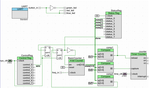

On the frequency counter front I now have a pure hardware solution. The hardware once armed will capture and hold the count until rearmed. This allows firmware to go off and do variable length operations without interrupts from the frequency counter or loosing the count. Here is the block diagram of the engine:
Basic operation starts on the left.
The controlreg is set up in pulse mode so when I write a 0x01 it pulses the arm net.
The first flip flop gets set
The second flip flop gets reset clearing the done bit
the done bit gets inverted which enables the 4 bit basiccounter1 and it starts counting pulses coming in the freq_in pin
The count from that counter feeds 3 comparators
     The first one is takes care of resets and is done at a count of 1.
          It reloads the counter (sets the count to 0).
          And it resets the first flip flop to remove the reset signal from the second.
     The second one pulses the capture pin to hold the count at count 14.
          Due to this setting being greater than 2 I count over a number of pulses which results in averaging several pulses in hardware.
     The third takes care of the stop at count 15.
          This is done by setting the second flip flop.
When the second flip flop is set the done bit gets set and the enable to the basiccounter1 is cleared so it stops.
At this point the counter on the right is holding the number of 24MHz pulses from time_clk that went by while freq_in pulsed 13 times.
Since my application does not need real world values I just left the counts raw.
In dry dirt I saw ~0x3E00 while in wet dirt I saw ~0x5200 counts.
Those reading match up to the trends I saw using a scope in a earlier post.
My basic program is attached. To try it connect to the USB to serial bridge at 57600 8n1 no flow control. Then press "a" to arm the counter and it will automatically return the status and count in 0x[status]  0x[count] format. Note the count is not valid until the done bit is set (bit 7 of the status) Note pin P1.0 is the freq_in pin.
