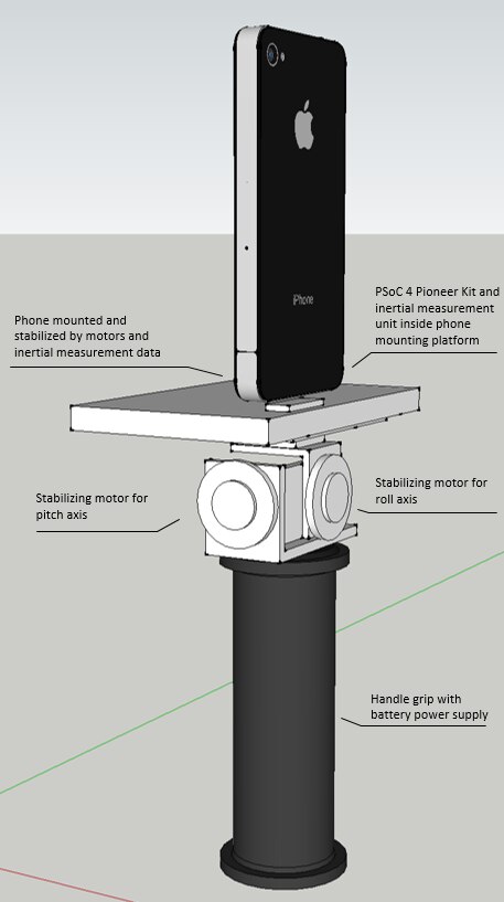

The use of stabilizers is proliferate in the professional cinematic market.  Modern cinematic sequences require such equipment for smooth camera maneuvers during action shots.  However, the equipment is often heavy and the cost is usually prohibitive. These devices wouldn’t make sense for the consumer market anyways.  I’d like to see if I can engineer something that is affordable and lightweight.  It would be a mechanized gimbal “for the rest of us”, for use with consumer phones and point-and-shoot cameras.
The device will be battery powered, small and lightweight.  A video recording device is mounted on a mounting platform with two motors.  The two motors allow the device to tilt freely in two separate axis.  A sensor board with a 6 axis accelerometer/gyroscope IC will be mounted alongside the video recording device, sensing the inertial movements. The inertial movement data is then fed to the PSoC 4 Pioneer Kit, which will calculate the motor controls required to compensate for the jerky movements of the camera operator.  This will provide stabilization for the video recording device, allowing video to be recorded without sudden jolts and shaking. The device will be fixed on top of a grip-like handle, allowing the gimbal and video recording device to be effortlessly operated.  I made a Sketchup model of the device, seen below.
(Iphone not included)
I’ve booted up my share of development boards before, so I’m sure Cypress’s package for the PSoc4 will be very robust and capable.  What I am concerned about however, is the fact that I have very little experience in dealing with inertial measurement units (IMUs) and absolutely no experience in dealing with motors.  This should be quite an exercise in discover for me.

    Hello Jianyi,
    Have you taken a look at Simple Brushless Gimbal Controller — Video ? It's a product based on the MPU6150 IMU, and a few brushless DC motors. I'ts made for quadcopters. Very nice control, might be interesting to see if you design will also work on quadcopters, maybe you should get in touch with yuritikhonov, who's also participating in this PSOC challenge!

    To help with your development have a look at the Project #053 - PSoC Eye project.
    It uses two servos for panning and tilting.

    Interesting idea.
    Are you planning to use servos to keep the camera steady?
    Have you considered adding a gyro stabilizer for the roll axis?
    I did a similar project about 30 years ago to stabilize an airborne FLIR compensated for flight vibrations, so if you set up the proper set of correction vectors, you should be able to do a good job with the Cypress processor.  I did mine with an Intel 8085 and your ARM processor is much better suited for it than I had.
