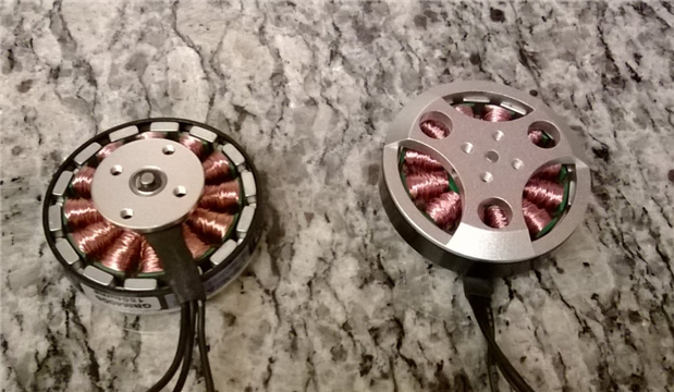

We can reduce the overall cost of the device by using a 3 phase motor and building a drive circuitry ourselves.  It sounds like a lot of fun anyways, and might be a great learning experience.  I was able to score some neat brushless motors on EBay.  There are 12 coils (4 coils per phase) and 14 magnets on the motor, and I am still trying to figure out how to control these things.
