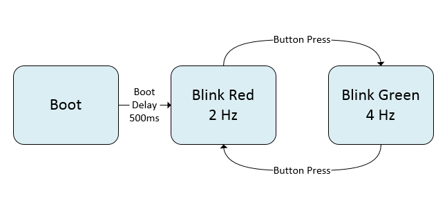

So what does a program written for the QP framework look like?  Well I’ll illustrate it with an example.  After porting the framework, I was able to put together a test program.  Below is a state machine of the program that I wanted to write to test out the timing controls, the inputs and the outputs (for the nitpicky RTOS pros, I am not following the UML standard, all the states are just plain Visio boxes).
The program is fairly simple, but deals with inputs as well as outputs.  The program has 3 states.  It boots up, waits for half a second, and then goes into the red LED blinking state.  In this state, the red LED blinks at a rate of 2 Hz.  If a user button press is detected, the state machine exits the red LED blinking state and enters the green LED blinking state.  The green LED blinks at 4 Hz.  If the user button is pressed again, the program returns to the red LED blink state.

The neat thing about using a framework is that you can put snippets of code that executes on state transitions.  In the MainFsm_R state for example, the 250 ms timer is activated on state entry.  It doesn’t matter if the entry is from the MainFsm_Boot state or the MainFsm_G state, the timer will always turn on.
In the program, I use two different types of timers, the one-shot type and the repeat type.  The repeat timers are used to generate the blinking LEDs while the one-shot timer is used for the boot-up delay from MainFsm_Boot.
One of the pitfalls of not using a state machine is that the program tend to turn into spaghetti code. I’m sure everyone’s seen their share of severely nested case statements and if/else trees.  By using the structure provided by the QP interface, a very complex state machine can be created without the code turning into a mess. The framework even allows nested states, so that a behavior that is common to several state can be grouped into a single superset state.  This way you only need to define the common behavior once, reducing code size and avoiding nesting of flow statements.
