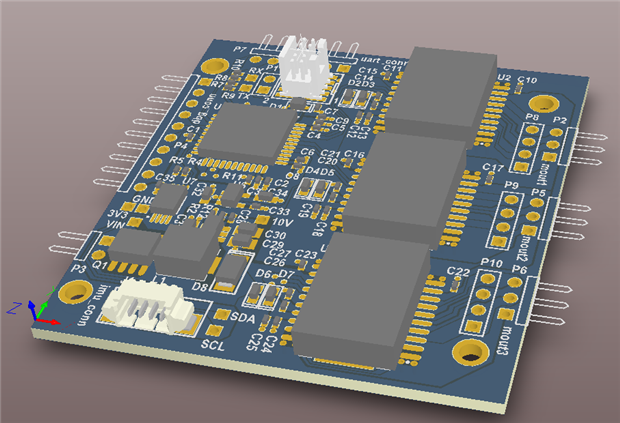

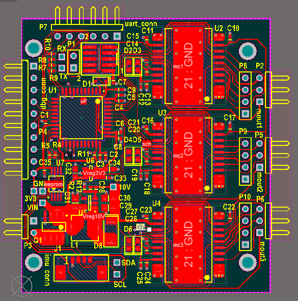

I was able to get a lot of work done over the Thanksgiving weekend.  The bulk of the hardware is completed, and now I am shifting the focus over to the software.  I am traveling this week so I don’t have much time to divulge much on the analysis of these boards, so I will just post the schematic at the end of the post.
The system diagram that was drawn in the earlier posts has now been realized in schematic form, and you can see that it follows the diagram pretty closely.
The PSoC is at the heart of the design and will control the motor drivers primarily through PWM blocks. I haven’t tested the PWM blocks, so I’m crossing my fingers that I can figure it out quickly.  Other than that, the power supply was covered last week and the remaining portion of the design is mainly test pins and connectors.  It took a week for me to find the time to finish doing layout, but it is ready to be fabbed.

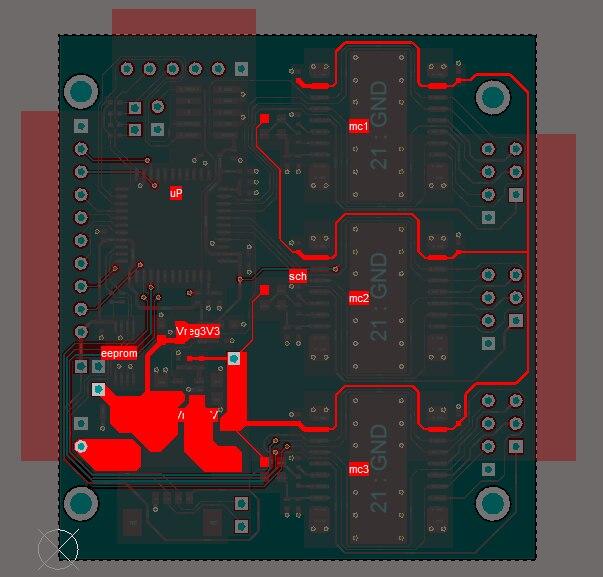

There are two main things to look for when doing layout.  Once is high current and the other is high speed.  In this case, there is no high speed traces, but I am a little concerned about the high current motor drives.
In this diagram, I highlighted the main current path.  Since this is 2 layer board design, the return path beneath the main current path should not be interrupted.  The hard part was trying to route as much as possible on the top copper so that the bottom copper stays solid under the highlighted nets.  Pin swapping is a god-sent feature when doing something like this.
That’s it for now.  I’ll be overseas for the week, but I’ll try to submit this to a fab house so that I can get it soon.  Hopefully all this effort pays off and the board actually works.

    jliu83 over 12 years ago in reply to vsluiter
    Yeah, I thought about it on the plane ride.  I think I'll do some rough calculations to make sure the copper doesn't vaporize.  There might be a revision before it goes into fab.
  • vsluiter
    vsluiter over 12 years ago
    Hi Jianyi,
    You made a very, very fast schematic and layout, that was a very efficient thanksgiving!
    Regarding your power traces: I'd be VERY suspicious about those. You calculated 1A from the power supply, I saw in the schematic, so each driver will get .33A continuous. However, as this is a switching converter for the motor, the peak currents will probably be quite high... I think I would've switched to a larger board or a 4-layer design... But the proof of the pudding is in the eating!
    DAB over 12 years ago
    Nice board work.
    I agree about the motor lines probably needing heavier traces.
