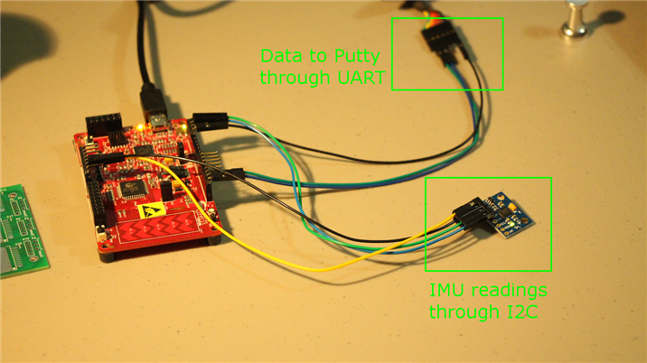

As for the Steady Clip, here’s the update.  I was able to get a UART connected to the prototype board, along with an I2C connection to the MPU-9150 9 axis accel/gyro/magnetometer.  I’ve attached a photo and a video of the Putty screen show the raw data being read from the device.  The parts have come in for the custom PCB, but I have not yet gotten around to finishing assembly.

    The absolute reading is a little high.  Magnetic field in Northern Cali should be About 50 uT, but it's reading about 70 uT.  I don't plan on using it on the first version since the motors will not be on the yaw axis, only pitch and roll.  Also, I cannot generate a fixed magnetic field to check the absolute accuracy, other than the earth's north-south field.
