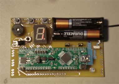

Here is the latest update on my work on the brainwaves appliance controller. Last update I showed how I designed a new prototype board, which probably will be the last prototype until I design the final product.   In the meantime the board came back from fabrication and I have soldered all the components.  Here is a picture of the assembled prototype board.

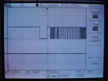

So I started to troubleshoot this problem, and the first thing I measured was the signal sent to the infrared LED, as you could see towards the end of the video.  This signal is shown in the picture below:

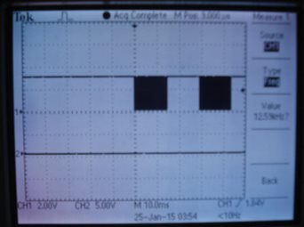

I then used the built in frequency measurement function of the oscilloscope to read the frequency, which came as expected around 38kHz.  The problem with this signal is that there is no pulse modulation; there is only the carrier transmitted in two sequential periods of time.  Next I measured what the infrared receivers read from the remote control during learning mode.  The waveform is shown in the figure below:
Notice on this picture the preamble followed by a sequence of pulse-width modulated square waves.  This is the demodulated signal which should correspond to sequences of 38kHz carrier for pulse low regions and flat zero volts for pulse high regions.  But the system does not recreate this signal; the signal sent to the infrared LED contains only the 38kHz carrier component.

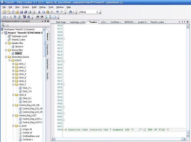

This means that the prototype system does not work properly, so I continued with looking at the code that runs in the Cortex MCU inside the Cypress PSoC5LP.  So I opened the main.c file and to my surprise the file was unexpectedly ending at line 948, as I am showing in the following picture.
This was strange, so I thought that the main.c file somehow got corrupted while installing the new version of PSoC Creator.  So I said “no problem” I have the file saved in the archive.  I opened the main.c in the archive with notepad and it looked complete, so I copied it from the archive and reopened the project.  But PSoC Creator showed, like before, only 948 lines, which surprised me again.

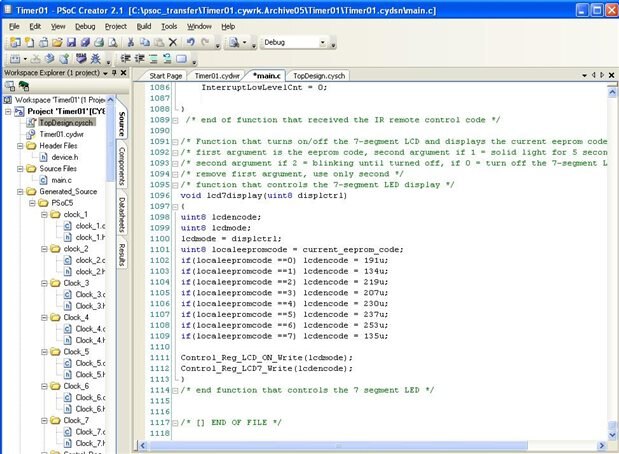

I did not despair and I opened the old PSoC Creator 2.1  that I still have installed on a different computer, and there the main.c file looked complete, as I am showing in the following plot.
Notice the end of the file is now on line 1117.  So something is going wrong with the newly released 3.1 version of PSoC Creator that makes it not show all the lines in my main.c file.

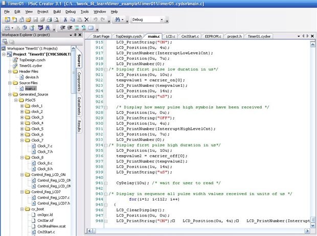

Looking with more attention at the main.c opened in PSoC Creator version 3.1 I noticed that actually all lines between 949 and 1117 are “clustered” in a single very long line 948, as I am showing in the screenshot below.
Notice the end of the file that was supposed to be on line 1117 is now at the end of the long 948 line.  Sweeping left to right I could see that all the information contained in lines 948 to 1117 is contained now in line 948.  The square symbols might correspond to new line characters.
But again I did not despair and I started to “brute force” edit the main.c file to add “Enter” commands and split line 948 into individual lines all the way to 1117.  But PSoC Creator did not cooperate and acted strangely by changing my edits on previous lines, deleting some characters, so after a few tries I decided that all my efforts only prolonged the misery and the real solution would be to get the PSoC Creator fixed.
So I am stuck now: I have a PSoC 2.1 project that has two missing operational amplifiers in PSoC5LP chip resources but it shows all lines in main.c, and I have a PSoC Creator 3.1 that has all four operational amplifiers in PSoC5LP resources but it “chops” my main.c file.
