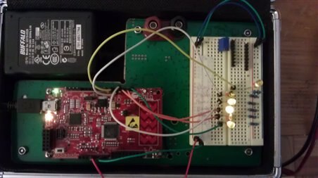

I chose the Pervasive Displays panels, not because they were the best choice, but because they appear to be the only e-paper choice for hackers. I wrote my own driver to understand the interface, but so far it isn't working (Grrr). My first step was to verify all of the IO twiddling (that’s a technical term).
The interface appears to be correct so there must be something in my SPI setup. With luck I’ll get that working in the next day or two and can move forward. I owe a salute to repaper.org and Adafruit for their interface board, library and tutorial. I didn’t use their files as a starting point (they are for the Arduino and MSP430), but when mine didn't work I compared code to make sure my interface is behaving the same and used an Arduino to verify my EPD is working (it is).

Breadboard Tip
One thing went well for this project. Every time I use LEDs I have to verify the Cathode and Anode and I still get it wrong sometimes. I had an epiphany while working on this project. I put a red paint pen mark on the Anode side and a black paint pen mark on the Cathode side on the LEDs in my breadboard kit. Whoopee! Now I’ll always know which way they go.

    steveturner over 12 years ago in reply to COMPACT
    I have a bunch of cheap LEDs in my parts (including these) that don't have a flat.
  • COMPACT
    COMPACT over 12 years ago in reply to steveturner
    The sure fire way to get it correct for round LEDS is that the Cathode is indicated by the flat portion of the package perimeter.
  • steveturner
    DAB - I agree about traveling and computers, unfortunately mine died a few days before I left, sitting on my desk.
    COMPACT, you're right about the longer leg. I just don't use them often enough to remember which is which, so I always have to either look it up or measure the diode.
    Victor - I didn't know that was standard. I might be able to remember Cup = Cathode. Thanks!
  • vsluiter
    vsluiter over 12 years ago in reply to e14 Contributor
    And most LEDs follow this rule: the Cup is the Cathode. If you look sideways to the LED you'll  see that one of the connections forms a sort of cup. This is in >95% of the LEDs the Cathode.
    Infrared emitter LEDs  sometimes are reversed.....
    I was just wiring up something with LEDs and something I had forgotten was refreshed.  Most if not all thru hole leds have one leg longer than the other.  That's the Anode leg.
