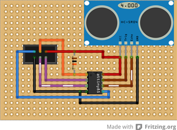

Ultrasonic sensor:
Hardware:
     HC-SR04
     Attiny85
Software:
     AVR sample
Progress:
In this specific area I have modified my original idea. Since Ultrasonic sensors are always spitting out a value, I thought this might consume a lot of resources from the PSoC and also I would like this to be compatible with different sensors. So I will be implementing a co-processor for the ultrasonic sensor. The Ultrasonic sensor will be manage with a small AVR, the Attiny85.
By using an Attiny85 I can be constantly measuring distances of objects and provide intelligence to the sensor. For example i can send a serial message from the PSoC to the Attiny with a distance threshold and receive from the Attiny85 an interrupt to log the data at that moment. Also by using this, I can latter on add a different sonar sensor without changing my PSoC code, just adding a simple smart component to the sonar sensor.

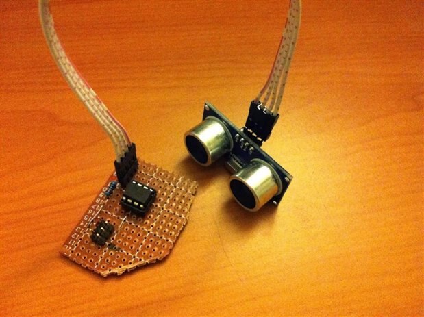

    This is how the prototype looks like. For now it seems a little too slow on response from the sonar. Also this is not the sonar I prefer since it is has a pretty short distance. Like 170cm tops. For now…
  • camuyano
    camuyano over 12 years ago
    This is how the prototype looks like. For now it seems a little too slow on response from the sonar. Also this is not the sonar I prefer since it is has a pretty short distance. Like 170cm tops. For now it should work. The software serial has not been put together, just decided to solder the simple board and test it with a the sonar and a LED.
