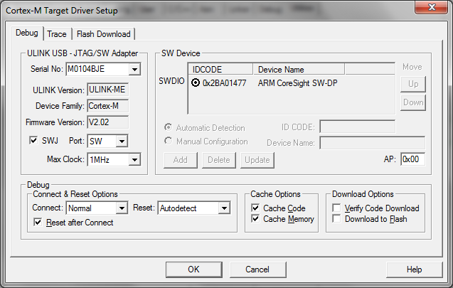

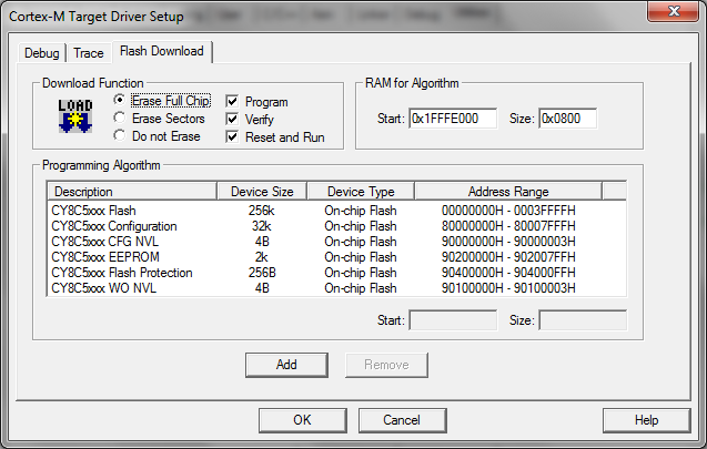

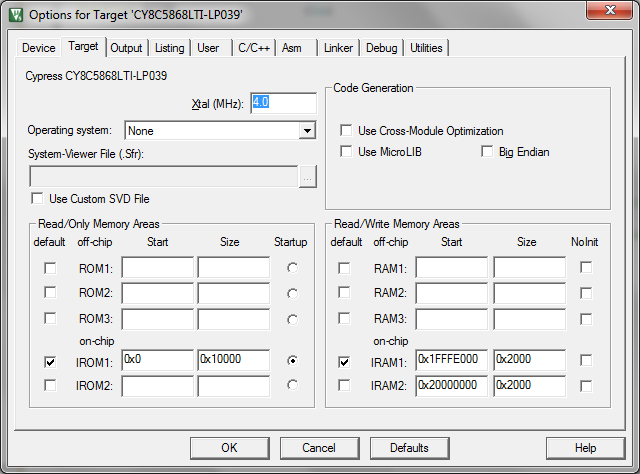

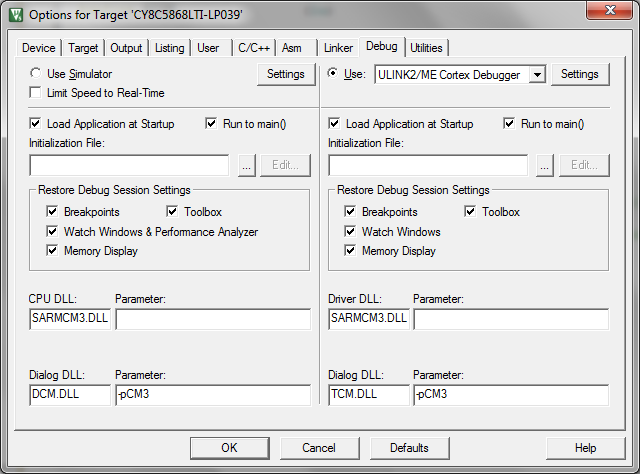

    Here are screenshots of the setup screens. Do you see anything in here that is different?
    Check the part number and ROM/RAM addresses.
    Check you are set up for a ULINK2/ME.
    Is the RAM for algorithm correct?
    Can you see the device?

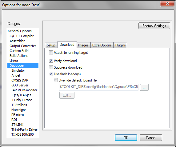

    Now comes the fun part, by following exporting guide i was able to make it work with IAR ARM, and guess what, same problem. I can flash program with no errors, debug it by steeping each line and it is working from IDE point of view. What is strange that i can't see any activity on pins even with scope, i try to use other pins, but get same result.
    So now i started to think that maybe that is strange hardware problem.I am using 3.3V for all IO banks, and Vccd is unconnected but bypassed, and voltage reading is 1.8V on Vccd, same apply to Vcca, it is only bypassed to ground with 1uF capacitor.
    As you mentioned earlier, i do supply power to PSoC5LP with on-board 3.3V LDO, and i don't have any problems with drivers. Also i can detect device, and i am not running debugger in simulation mode . uVision settings looks the same as in your pictures, and SWD can detect arm m3 core as you shown in pictures. I have no idea what's wrong.I checked all pins under microscope, and i have connections without any shorts. Also, if i can debug program, how can it don't work ? that is what boggles me the most

    Hello, bottom line is this. I don't have SWD that can work with PSoC Creator and i need to be able to program PSoC5LP and PSoC4. Since i have Ulink-me, i try to export my project from PSoC Creator to uvision. When i connect Ulink-me i can't upload program because i get verification failure, if i disable that, it looks like code is uploaded, but i don't see any activity on any pin ( like led toggle or constant PWM). Same apply if i try to debug project. I can enter debugging session, step in code, but again, no activity on GPIO image

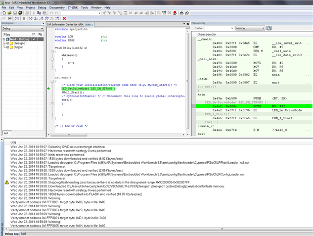

    Ok, since i have IAR ARM (STM32F429 is programmed via IAR) so i tried to do the same, since i can export files from PSoC Creator to IAR ARM. As with uVision, i was able to compile and even upload without any errors code to internal flash, also can debug it by stepping code and it looks like processor is running, like stepping over Delay(0xFFFFFF) take some time. But again, no activity on GPIO (like led toggle or constant pwm). IAR ARM use STLink V2 programmer as my original GUI controller

    We have never tried the ST debugger with PSoC. I assume it reuses the ULINK flash loader files but it is very possible that the ECC memory is not being programmed with your HW configuration. When this happens your program looks "right" in the debugger because the code is correctly written in flash. But it does not work because the pin, in your case, has not been initialized to be a strong drive output.
    Please add the following line in main(), before the loop, and see what happens in IAR.
    LED_SetDriveMode( LED_DM_STRONG );
    If the above is right then we'll know that your PSoC is alive. Unfortunately,it will also point to a problem with the debugger probe setup, which I am not sure I will be able to troubleshoot, since I do not have one and no-one at Cypress has ever tried to use with our devices.

    Well, i added this line, nothing happened.
    It uses $TOOLKIT_DIR$\config\flashloader\Cypress\PSoC5LPFlashLoader_xx8.board flash loader file (attached to this post)
    as uVision, IAR ARM can verify downloaded code and yes, as it turns out i have errors while uploading.

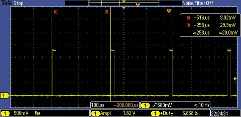

    ok, i found, is P0[0], and it was connected to 2.2uF Low pass filter capacitor image
    anyway, recompiled to get it working on P1[2] and yes, i have low duty cycle square wave
