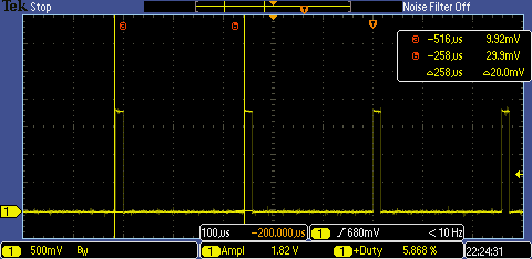

    what is pin number for this project, can't found it in uVision ( i mean, don't know where to looks, in PSoC creator is very easy to see in )
    LED on my board is P1[2],
    ok, i found, is P0[0], and it was connected to 2.2uF Low pass filter capacitor image
    anyway, recompiled to get it working on P1[2] and yes, i have low duty cycle square wave
