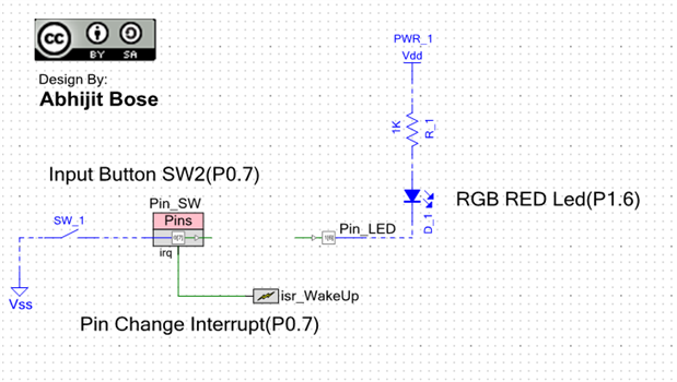

Here is the Application schematics:

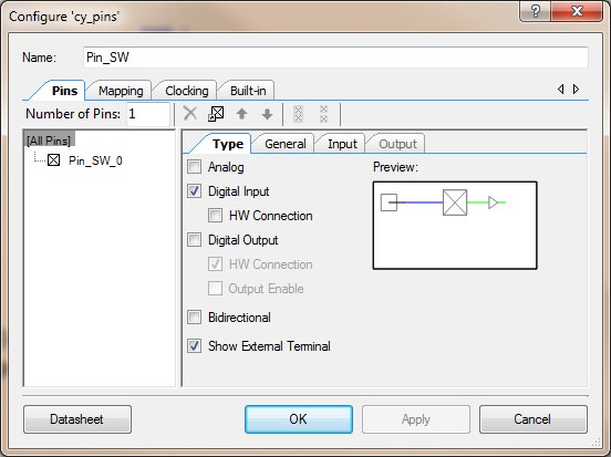

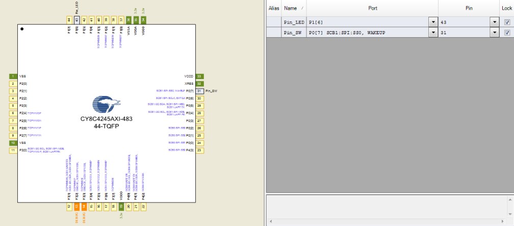

This examples uses and non-hardware connected pins, so the pin components inserted this needs to be disabled.

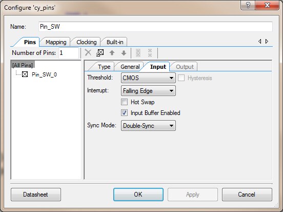

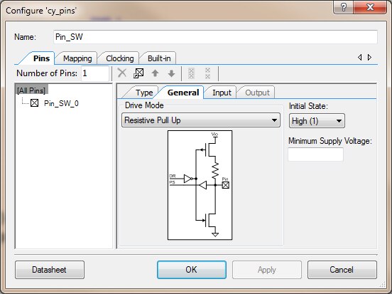

The input pin needs to be configured so that its able to have a internal Pull up enable to help in default value stabilization and an interrupt on Falling edge as pressing the button would set a Logical low on the input.
The specific configurations for the PinSW { Digital Input Pin [v1.90] } are shown below:

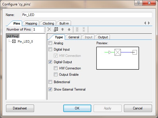

Similarly the output pin { Digital Output Pin [v1.90] } need to be configured as follows:
