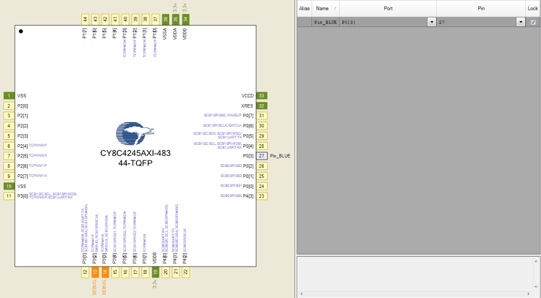

This example deals with setting up a PWM to blink an LED on the Cypress PSoC4 Pioneer Kit.

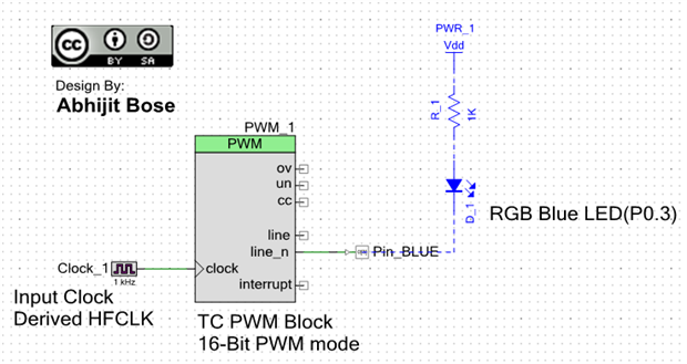

Here is the Application schematics:

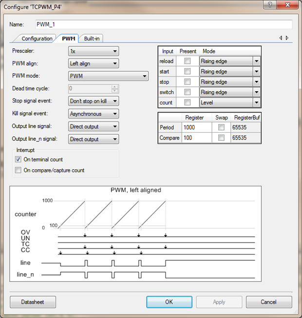

Also one needs to configure the PWM block { PWM (TCPWM mode) [v1.0] }:
