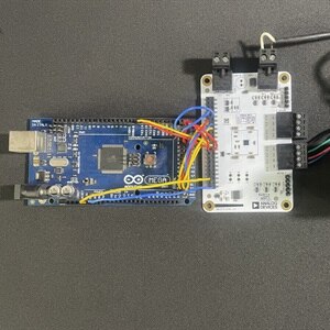

The TMC5272 motion controller supports both SPI and UART. The C code I downloaded implemented both the protocol. I connected an Arduino MEGA with the TMC5272 board following the configuration shown in the code. The connection is as follows:
Arduino Mega Pins
TMC5272 Eval Board Pins
51 MOSI 32 SPI1_SDI
50 MISO 33 SPI1_SDO
52 SCK 31 SPI1_SCK
53 SS 30 SPI1_CSN
GND 23 CLK16 -> use internal
23 DIO 19 nSleep
GND 2 GND
+5V 5 +5V_USB
27 iRefR2 35 IREF_R2
29 iRefR3 36 IREF_R3
31 uartMode 20 USEL
For initial testing I did not change any connection. The following photo shows my connection between Arduino and TMC5272 Eval board:
