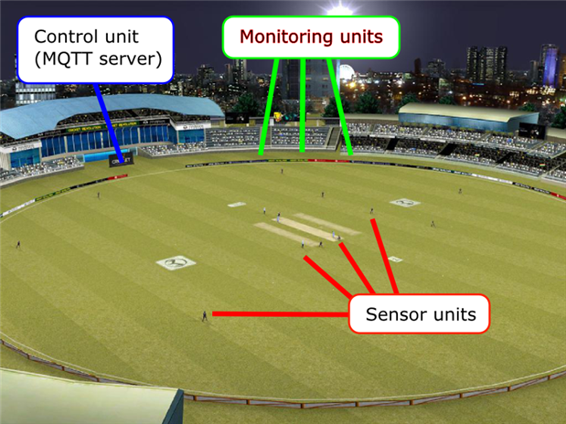

Project description
Regarding the proposed system, I plan to make it modular and easy to configure and use.
a) Modularity will make the system more generic and it will give the opportunity to easily setup the remote unit for different sports.
For this to work, I will have to make small remote sensor modules that can be fitted into casings that are customised for some sport outfit (at first I planned to make these casings 3D printed using SeeedStudio service but I will probably try casting them using the provided resin - this must be pure fun). Also, the main remote unit to which sensors will be connected must be small enough to fit the helmet or to be placed inside a small shirt pocket in such manner that it does not affect the sportsmen performance in any way.
It will also require a battery power and LiFe or NiMh batteries should be a good choice since these types of batteries are much more durable and not so flammable as LiPo and LiIon batteries are. Battery must have enough capacity to last for the entire training session without having to be recharged but not to big at the same time since we need the entire sensor module to be as small as possible. For some sports, weight is critical. Battery will be connected via wires to enable flat form factor when needed.
Sensors will be connected to the central remote unit (Arduino mini or  Adafruit Trinket pro) via cables/connectors or BLE (when wires are not an option).
b) To make the system easily configurable, remote sensor modules will use wireless connectivity and operate in AP mode when switched on for the first time to enable easy connection from the control unit (probably a tablet computer but during development I will use a regular lap-top or Raspberry Pi). Remote units will have unique SSIDs consisting of a common prefix and unique part to distinguish between different units. This way, control unit will be able to enumerate all the available devices without having to connect to each of them. The unique part of SSID will be preprogrammed and visible on the device so that operator can assign device ID to corresponding sportsman in the database.
Control unit will automatically send configuration data to each device that operates in AP mode by connecting to each of them as a wireless client (one-by-one).
Configuration data will let the remote unit "know" which sensor modules are attached to it to be able to communicate with them.
After configuration is done (including the wireless network selection and required credentials passing) remote sensor units will switch to wireless client mode and connect to the selected wireless network and then again to the control unit. Remote units will publish sensor data updates using MQTT protocol (a lightweight C client is available for embedded devices at Paho - Open Source messaging for M2M). Control unit will also run a MQTT broker service and dispatch the received data to all monitoring units (laptops, tablets or mobile phones). I'm already working on a similar software for the InTheAir design challenge so this should be the easier part.
I think that this concept would work and could be done in the given timeframe. In the first stage, software design is my main concern until I receive the challenge kit. After the sensors tests are done using provided development kits, a remote sensor unit circuit will have to be designed for the final product.

    One thing you need to consider (Well I am sure there are many but im pointing this one out specifically), Bluetooth is not know for range (10-30Meters at best and in absolute ideal conditions), you may…

    As far as i know BT4.0 supports meshing... So may be each player could act as a data repeater :-)

    I'm already too much into the WiFi option image About to order a couple of Microchip's WiFi modules with external omni antenna, should be good for this application.
    But I never worked with BT modules before and would love to try that out too. I'm thinking about making one of the sensors connected with remote unit using BT modules but still not sure about it. It might be too much.

    I was thinking about using BLE only for communication between sensor module and main player unit. Main remote unit will send the sensor data further to the control unit (MQTT broker) via WiFi.
    I should have made a sketch for the remote unit too to make this more clearer.
    2.4Ghz should be fine if good antenna is chosen. For my RC modelling hobby I use a 2.4Ghz transmitter and it has 1km+ range with simple omni-directional antennas.
    Here you can see the range test for ESP8266 WiFi modules I intend to use (already ordered one for test): https://www.youtube.com/watch?v=7BYdZ_24yg0#t=385
    The field picture I used for illustration is just a picture I picked up to give some visual representation of system so it's easier to explain how it will work. The idea is to make the generic system, not strictly bound to a single sport discipline.
