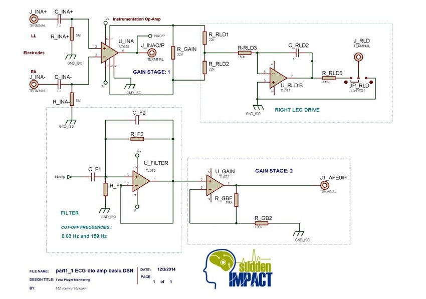

Circuit for basic Bio-amp
As the design kits are not available right now, I am using this basic bio-amp circuit for temporary experiments. I would like to check whether the proposed LEAD arrangement is capable of acquiring ECG LEAD II effectively or not.
If the basic Analog Front End using AD620 works with proposed arrangement, then AD8232 will replace it later on with same configuration. Otherwise, the conventional configuration will be used with arrangement 1 or 2.
The output of the proposed LEAD arrangement will be published next week in my 2nd blog. It will be compared with the output of the conventional arrangements and configurations for feasibility check.

  • sunnyiut
    sunnyiut over 11 years ago in reply to vsluiter
    thank you vsluiter,
    yes I have to put the parallel resistance. you are right.
    the R_RLD4 is missing here image
    it will be parallel to C_RLD2. Thank you
  • vsluiter
    vsluiter over 11 years ago
    Hello Kamrul,
    A word of advise: your right leg drive is now a pure integrator; for DC it will have infinite gain, and will thus clip. You might want to add a resistor parallel to C_RLD1.
