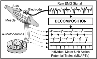

Background:
Electromyography [EMG] can be used to detect the responses from the muscle due to a certain stimulation. When we trigger the action potential inside the motor unit, it can be detected from the body surface as the body acts as a volume conductor. But the signal will be in form of a combination of number of action potentials of individual muscle fibers those are superimposed [fig-(a)].
Fig - (a): Superimposed EMG signal                                             Fig - (b): EMG taken from body surface for resting and active stages

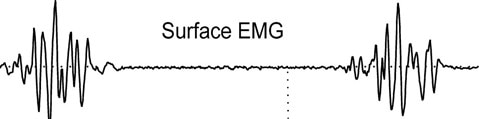

We can use two surface electrodes to detect the difference in response of two opposite muscles with respect to a reference.
It gives a steady signal during resting or relaxation. But during general muscle activity it gives us the differential signal in between two muscles [fig - (b)].

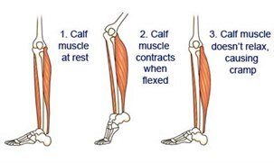

For normal contractions we have repetitive action potential with higher amplitude, where we have control over the frequency of occurrence. But in case of strain or cramp we loss our control over the motor units and repetitive action potentials are produced with very short delays. The amplitude also gets reduced. This case is known as Myopathic causing severe pain.
Fig - (c): EMG - normal & myopathic     Fig - (d): Calf muscle at different states     Fig - (e): Different stages of calf strain
In the initial stages of muscle strain or cramp the repetitive signals stay at background and start to develop as time passes. At severe case it gives stronger contracts than any sort of voluntary action and causes pain. As the muscle cramp is a non-voluntary action causing myopathy and follows Brief Small Amplitude Polyphasic Potentials [BSAP], it can be detected by analyzing the signals and comparing with the data received from normal activity.

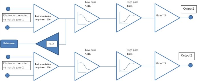

So, the first goal will be acquiring the EMG signals using AD8232 AFE for muscle activity and send it to the remote device where it can be observed visually.
Then, the second goal will be setting up an algorithm for analyzing the signal using ADuCM350 to detect any potential cramp or strain.
So far, I have developed the prototype circuit just to observe the EMG for different stages to evaluate the conditions.

Prototype:
The prototype circuit contains two separate electrode pairs for measuring the EMG at two different muscle zones simultaneously. It will help to identify the perfect zone for electrode placement. Also the differential output of the electrode pairs will ease the formation of the algorithm when they will be placed in both legs. So it will be possible to analyze the signals and compare them for different states. RLD bootstrapping is used for better noise immunity.
In my next blog I'll post the outputs of the circuit for different states and try to compare them.
