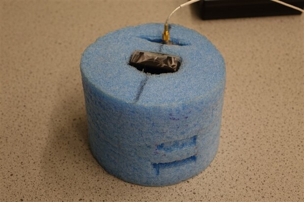

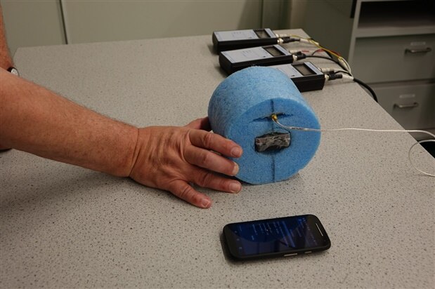

In the picture below there is the foam in which we placed a 3-axis accelerometer and one of the devices to be tested (here it is Hendrik's Skimonitor). We then dropped a ball onto the foam unit and then recorded the measurement reported by bnoth deviceds. for comparison. This is not a very precise method, but it suits to provide a rough order-of-magnitude comparison.

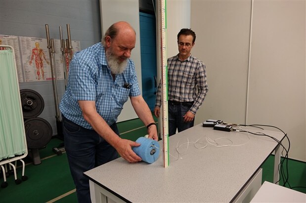

Here is Julian preparing the setup to drop a ball from a given height:
We did measure here the impact data reported by the devices of Hendrik Lipka and Ravi Butani.

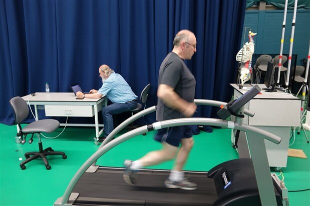

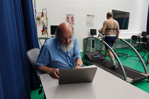

For the heartrate measurement, Michael strapped on one device after the other and brought up his heart rate by walking / running on a treadmill. His heartrate was about 160 at the peak level. He did measure the heartrate with a Polar heartrate measurement system as a reference. Then Julian, sitting at the laptop computer, wrote down the values reported by the individual devices.
We did so far record heartrates reported by the devices of Ravi Butani and Douglas Wong.

    I think the setup with the foam unit where you drop the ball on it will report too low values by all devices (because your reference sensor is accelerated more than the DUT). But the values should be at least comparable between devices, I guess.
    Btw: what do you use as acceleration reference sensor? Can we get a short report of how well our devices performed afterwards? (I'm just curious how well it did in the end)
