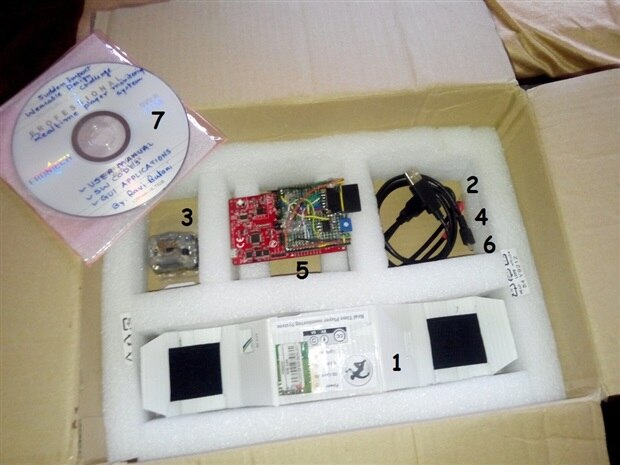

Check List (items Included in Shipment) :
  1. Chest Strap Module with micro SD Card (CSM)
  2. Chest Strap Module Charging USB Cable (CSM-CC)
  3. Helmet module (HM)
  4. Helmet Module Charging USB Cable (HM-CC)
  5. Multi Player Simulator module with micro SD Card (MPSM)
  6. Multi Player Simulator module with USB Power Supply Cable (MPSM-PC)
  7. CD contains necessary Software, User Manual and other documents
