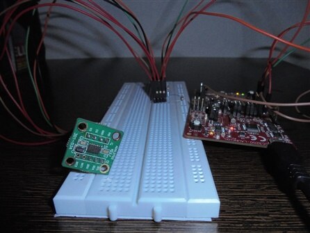

In my Previous Post , I have discussed Interfacing TMP006 contact less temperature sensor with CC3200 Launch Pad.... In this week I have received all Kits from ADI as part of this design challenge...
Today, I am sharing interfacing of ADXL375 +-200g Accelerometer with CC3200 LaunchPad, Using the same code you can Interface ADXL375 with Arduino or MSP430.... etc using Arduino or Energia or any uc Supporting Arduino like Library.
Test Setup....
Here is energia code for ADXL375 interfacing with CC3200 LaunchPad...

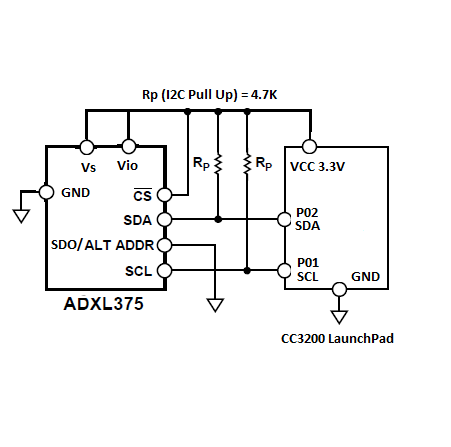

Interfacing Schematic...

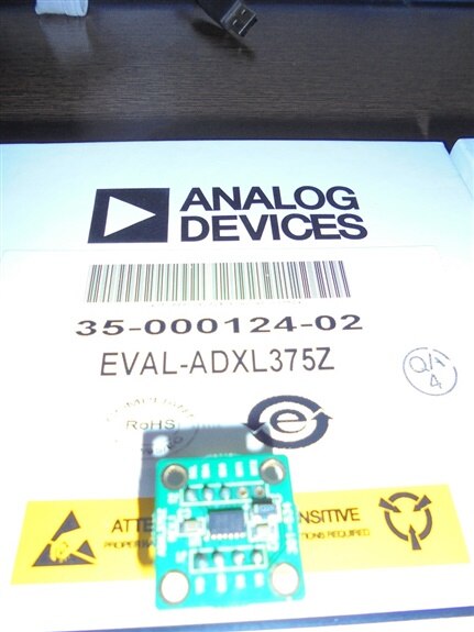

EVAL-ADXL375Z Breakout Board Pin-out..
