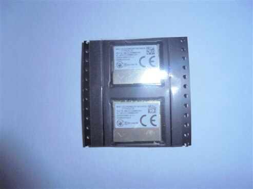

I have recently received CC3200MOD module samples from TI, So currently I am making custom PCB for this project around CC3200MOD..
