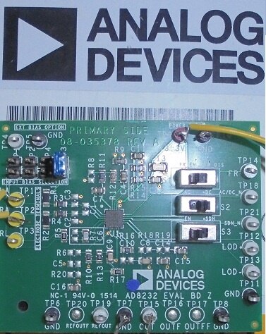

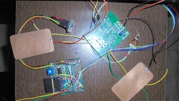

In My Previous Post I have shared Impact detection algorithm.. Today I am going to share AD8232 based heart rate monitor demo..
I have just used 4x5cm PCB as ECG Probe and TLV3402 Comperator to detect heart beat and to give interrupt to MCU (cc3200 in my case), Probe Placement is shown in video.
AD8232 Switch and jumper Configuration is as below...
Here is demo video of AD8232 based heart rate monitor...
As per video motion artifacts are very minor with this configuration...

    Based on measuring interval between two interrupts, I am calculating Heart rate per minute... Also I am doing Running AVG in MCU code for 10 measurement to avoid any error.. and unwanted flickering in heart rate result...
