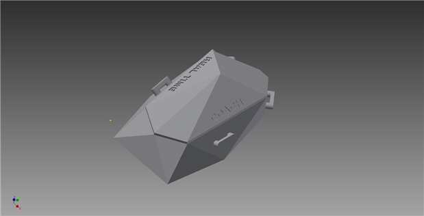

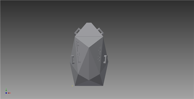

First: Design
I have finished designing the housing for the main wearable unit, but unfortunately all of the 3d printers at Purdue University are currently out of order or closed (yes, all of them), so I have been unable to print it. This housing is meant to hold the battery, arduino, xbee module, heart rate monitor, and an accelerometer. The whole thing is then worn on the back like a small backpack. For reference this is 5.75 inches tall, and 3.5 inches wide.
