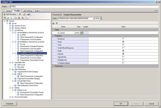

The BLE component contains the configuration of all the provided services and their characteristics:
I defined a custom service 'AccelHistory', with three different characteristics. The accel.rrd data contains the time series of acceleration, the accel.log stores data when too high acceleration values are measured, and accel.current returns the current acceleration. I use the latter one for experiments, since its easier to mock that time series data. In the final version its probably not available anymore.
You may notice other services here as well - I did utilize standard services to provide additional functionality. Immediate alert can provide push notifications to connected phones, and the Alert notification proves just a notification (like an incoming short message). Battery provides the battery voltage level, and Device information some meta data about the device (name, software and firmware versions and so on). I will experiment with them and see how useful they are in practice.
