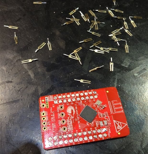

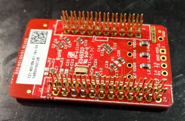

First item on the list to take the PSoC4 BLE module and remove the pin headers - the are just too high to make small enclosure. After using my hot air gun, the result looked like this:
Not really what I intended - but a good place to start removing all the pins one by one (using a desolder pump). The final result was this:
Having the module now in the right for factor (OK, getting rid of all the unused PCB space would be nice, but according to Cypress a smaller, standalone version of the the module will be available soonest in march) meant I can look at charger and voltage regulator.

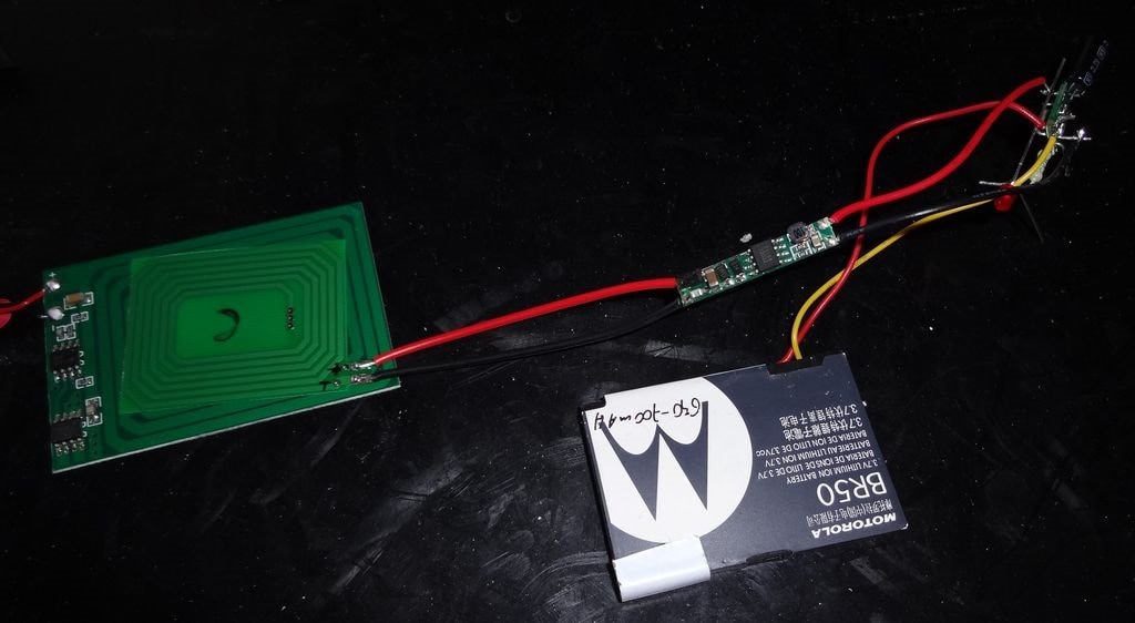

As already mentioned I use the LTC4054 LiIon charger IC. I had good experiences with it, it seems to be robust, comes in a reasonable package (SOT23-5) and needs just two external components (four if you need a status LED). I mounted in on a small SOT23 breakout board together with the passive components.
The PSoC4 itself would be happy running from 1.9V up to 5V, so I could connect it to the battery directly. But since the ADXL series all only run with up to 3.3V, I decided to use a 2.8V LDO regulator. I used an ADP162. It also comes in SOT23 package, and has a current consumption of down to 0.5µA.
So I mounted it on a SOT23 breakout too, and wired everything together (battery, wireless charger receiver, charger IC and LDO):
The receiver is placed on the wireless transmitter for reference - unfortunately the LDO and the charger IC are difficult to see in that picture.
As battery I used one from an old mobile phone, which provides me with all the safety and protection electronics. In this setup I verified that all works together, and that the battery gets charged properly.

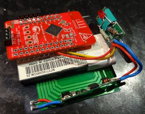

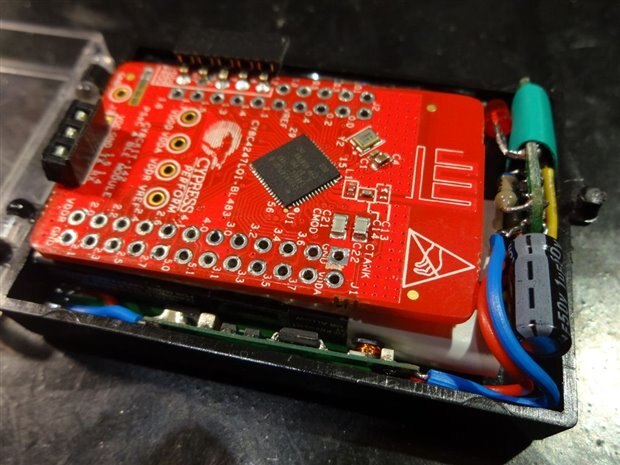

Next step was top put everything in the enclosure I want to use for my prototype. That meant shortening the wires, and stacking all the parts on top of each other:
I found a old sample box I had laying around for many years (anybody guesses where its from?), which fit the form factor of battery, receiver coil and PSoC4 module perfectly:
I have added a programming connector on the PSoC4 module, to be used with the MiniProg3 programmer. On the left is also a serial port connector, so I can get debug information (when mounted on the carrier board the PSoC5 there acts as a bridge, but now I don't have any connectors for that).
For all the hardware thats left (ADXL375 module, maybe a LED and a touch button) I will add flat header pins to the PSoC4 module, mount a perf board on it which then holds all of them. I think this all should still fit inside of the enclosure. The ADXL375 module is 20x20mm, but from the pictures it looks as if it can be reduced to 15x15mm, maybe even smaller).
I skipped on the programming port protection I outlined in my overview, since the case I'm using is protected enough not have snow inside of it (at least I hope so...).
