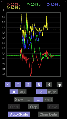

So this was a longer break, but the skiing vacation was really needed. Since I could not take my ADXL375 with me (though it arrived 2 days before I left) I tried to have some measurements. I was especially interested in getting some data about accelerations that happen during normal (downhill) skiing, and maybe compare them with what happens when I would fall down.

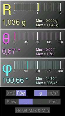

So I looked through the apps that are available on Android for measuring acceleration, and installed some of them. After playing around a little bit I settled with using Acceleration Monitor. Its most important feature was to calculate an acceleration vector, and storing its maximum value for the app runtime. All programs where able to draw nice graphs of the acceleration axes, some could also calculate the absolute vector. But a graph for the past 60 seconds or so doesn't help me, I don't want to look constantly at the phone (especially not with -10°C outside...).
The app not only calculates the absolute vector value, but also its direction. If you need, it can also store a graph, but there is no scrolling for history data...
So what did it report? Well, the highest acceleration it measured during skiing was about 2.8g. If you subtract the normal earth acceleration this leaves just 1.8g, which is not so much. Unfortunately (for this exercise) my skiing skills have improved in the last few years, so I did not fell down so often - and when I did, I had the app not running (it really drains the battery since the phone and the display are always one).
But there is one interesting comparison to be made: I had the phone in the front pocket of my jacket. And when I had the app running while just walking around (taking the skis, hopping onto the ski lift and so on) it reported an acceleration of up to 2.5g. Go figure. Surely skiing felt much more taxing than just walking around...

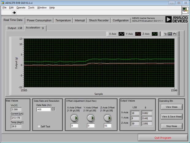

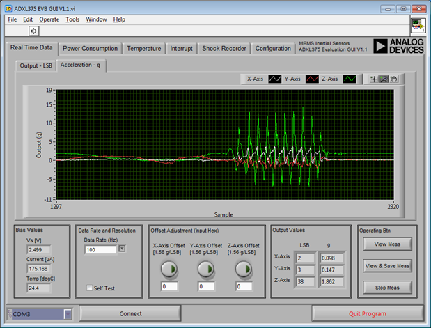

Having jumped through all these hoops, the evaluation is actually quite nice. The GUI allows to play around with all the features the accelerometer has:
You can look at the acceleration values for each axis, set the data rate and even see the raw values.
Since you can set the supply voltage (on the configuration tab), I played with it and discovered that the offset values for the acceleration depend heavily on the supply voltage. The jump here is by going from 2.7 up to 3.3V.

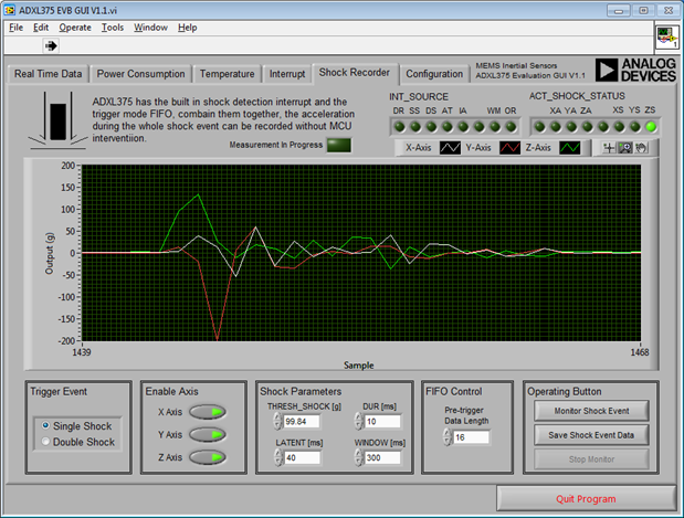

One can also configure and test the shock monitor. The values here are the recorded events. I also tested with the interrupts and their configuration, and played with the different data rates and their effects.

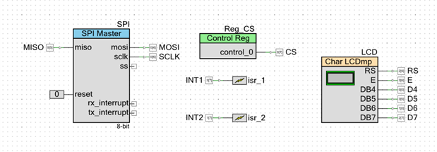

The ADXL375 and the PSoC4

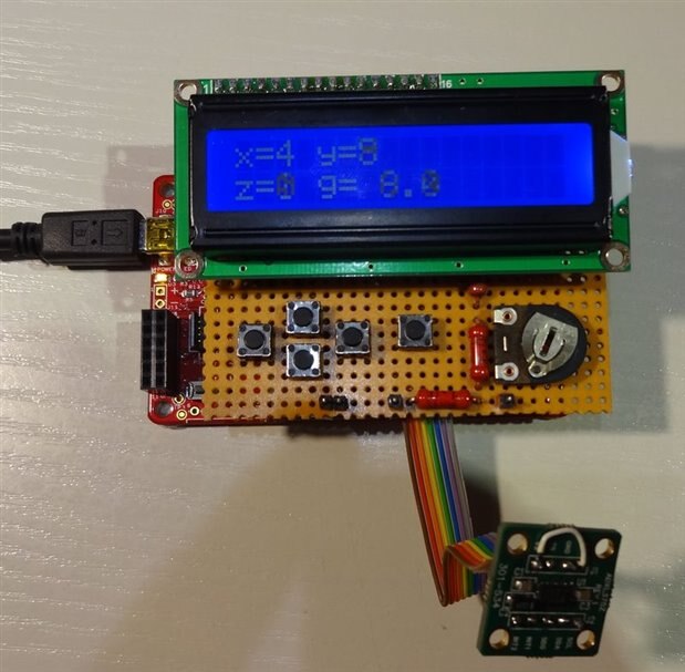

First task: connections. Since the PSoC4 BLE board, equipped with the breakout, is too high to safely accommodate my Arduino LCD shield (the shield would touch the breakout board) I used by Pioneer board for the task. So I soldered wires to the breakout, and right-angle pin headers to the other side of the wires. Placement of the pins needed some careful consideration, since the fixed-function SPI component of the PSoC requires some dedicated pins. And not all of them are available on headers, and some are used by the LCD shield.
I finally settled for a pinout, and started going. The Hardware side is rather simple, one juts needs a handful of components:

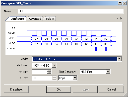

As already stated, I originally stated that I used the fixed-function SPI, but I later on changed that to the UDB-based version. I encountered a problem that might be a problem in the FF SPI component, so I wanted try the other one.
Its configuration also is simple enough:
No need to fiddle with registers or doing bit-rate calculation, just state what you need.
The software side is simple too, there is a nice API with just read and write and it takes care of all the rest.
First step was to read the device ID to see whether I can get the communication working. The code for that is easy:

Only problem: this won't work. It actually required that I used a scope to look at the SPI lines to see what happens (thanks to Tektronix for providing me with a TBS1202B-EDU, I appreciate that!). A logic analyzer would have been even better (and had solved that with a single glance). But looking at the signals ony by one revealed that the CS line goes to high even before the second clock pulse.
I should have known that: the SPI component uses a TX and RX FIFO, so the bytes to be send out are just placed there and then the function returns. So I need to wait for the SPI transfer to finish before pulling CS high again.
So I added this call too, and voila there was the ID (0xE5).
Next step was to read acceleration values. Trap for starters: the device powers up in power-save mode, so it doesn't to measurements at all. One needs to set it to normal mode to get any data. Doing so revealed data for all three axes:
I also calculated the absolute value of the acceleration value, since this is the final value I need. What I noticed is that there is a heavy offset. According to the data sheet the normal offset is 0.4g, but can be as high as 6g. My device shows for Z an offset of 1g, so if I put it upside down it shows 0g, but 2g in normal position. The x axis is also way off.
So I know that I need to handle the offset. The ADXL375 can do that in hardware, but a resolution of 1.56g per LSB is quite coarse. So I will do that in software, and trigger it via the phone app.
