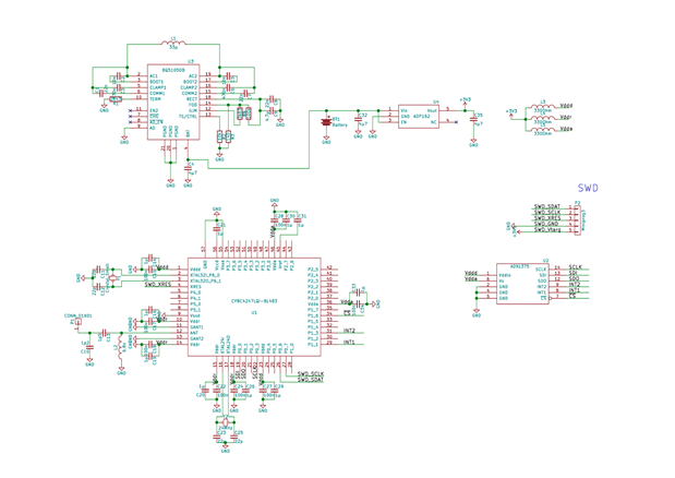

But I also made some progress on the skiing monitor side of things. Even though work on the software was slow, I started planning and designing the final circuit. Christian was so kind to send me some really small Qi receiver coils, for which there is a really small reference board from TI (using the BQ51050B, which also acts as a charger). This coil is 26mm in diameter- and the reference PCB just 5x5mm. I think my PCB will be a little bit larger since I use the QFN package and 0603/0805 SMD parts.
So the BQ51050B gives me a Qi power receiver and charger. Next in the line is a ultra-low-power LDO, the ADP162. These two chips form the complete power management. Apart from them only the PSoC4BLE (a CY8C4247LQI-BL483 in QFN56 package) and the ADXL375 is needed. Most of the passives are for decoupling, the PSoC4 needs two crystals, and the antenna circuit is just a capacitor, and inductor and a PCB trace. I'm curious to see how small I can make the PCB. When its finished, I will ask Cypress to verify it (esp. the PSoC4 footprint an the PCB antenna). Depending on how fast I can finish the PCB I need to decide where to. With enough time I might send it to a chinese factory, which will be really cheap. When I'm late, I'M thinking of using Würth (WEDirekt) again - they are about 8 times as expensive but much faster (to bad they are not sponsoring this contest too image.
Here the schematic:
As my "plan B" I might be able to use a (yet to-be-announced) EZ-BLE PRoC module from Cypress. These are small BLE modules, about 1x1cm in size, with a PRoC BLE chip on the (basically a PSoC4 chip with no configurable digital logic), all passives and an antenna. I would use it with the ADXL375 module board on a small carrier board. This will be larger than my own PCB, but much easier to manufacture.
