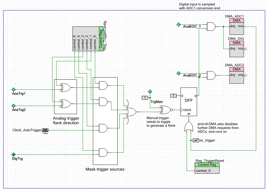

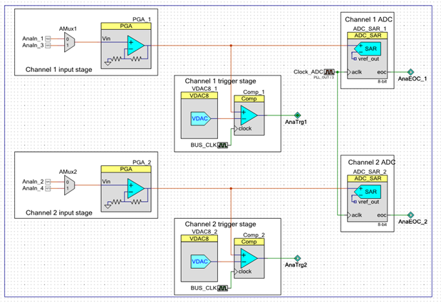

Lets consider for example the first project I ever did with a PSoC: my analog-digital-mixed scope. It combines a two-channel scope with an 8bit logic analyzer, a sample rate of 700ksps and a sample depth of up to 24kb. All of that, together with a flexible triggering circuit did fit into a single PSoC5 chip (and with a PSoC5LP it would even go up top 1Msps). Lets consider the triggering:
  • for each of the 8 digital inputs the logic level needs to be checked with the trigger definition
  • optionally each channel can be excluded from triggering
  • for each analog channels, the trigger level must be checked, and the flank (rising or falling)
  • and then the analog channels are handled as the digital ones (means they can be excluded)
In software this will be quite difficult, even with a core going faster than 80 MHz. But in hardware its quite straightforward, and looks as if you are looking a a normal scope:
(I skipped the digital input parts since its schematic is quite messy).
On the left you see the analog input - each channel can select from one of two inputs, and the runs through a PGA (so the input level goes from 5V full-scale down to 100mV full-scale). The trigger level is set with a DAC combined with a comparator.
On the right is the trigger circuit. The flank for the analog triggers is set with a XOR, and they are masked with AND gates (as is the digital trigger). When the trigger fires, is just starts the DMA engine that stores the sample in memory. So in the actual acquisition, there is no software involved at all. It is only needed for setup and display.
