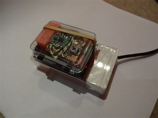

Here is what it looks like:
The device on top is the skiing monitor, the one on the bottom is the charging base station. The SkiMon is 50x40x25mm. This quite OK since its still a prototype. A final version can be much smaller, but more to that in the next post.
The SkiMon can be mounted on a helmet, but its not exactly unobtrusive. As can be seen its charged via wireless power transfer, so there is no charging port needed. For my prototype I used a normal push button for interaction, but this can be replaced by a CapSense button so the whole SkiMon can be encapsulated in resin if needed (though it should be clear one).
The battery runtime is more than a day, and the logging time depends on the software (right now I can see the last hour of data). I figure since any larger accident should be noticed directly afterwards this should be OK.
The device pairs with my Android phone (and should work with all BLE capable phones with at least Android 4.4) and transfers the logged data continuously when paired.

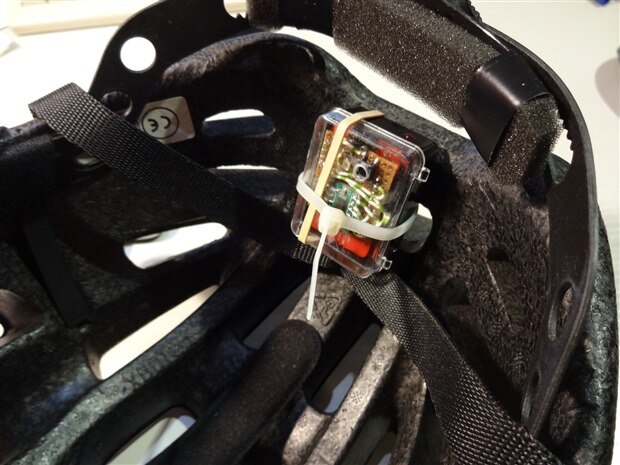

To show a more severe impact I mounted SkiMon on my bike helmet and did a drop test:

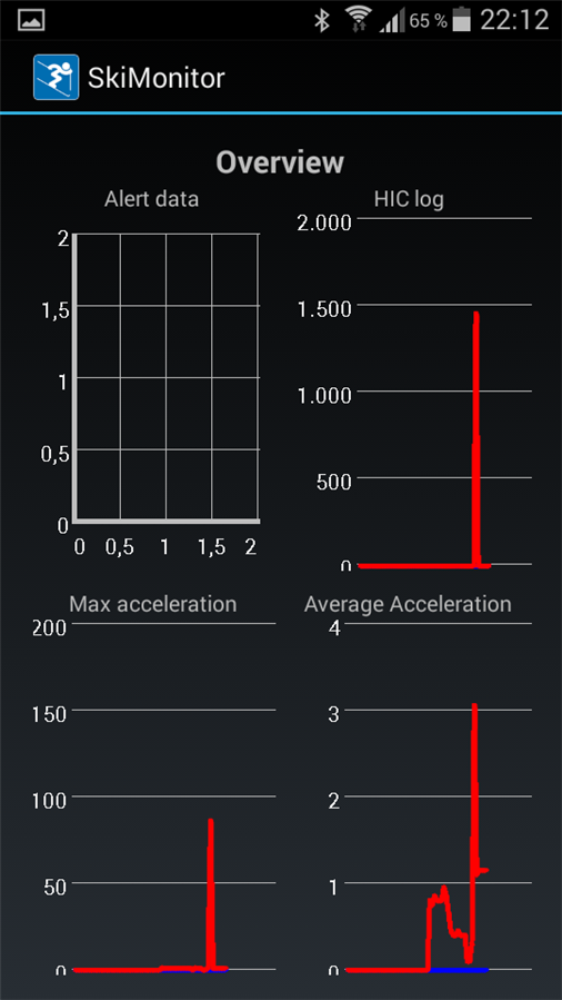

Then I let it drop from about 1m heigth (with the back of the helmet, where the device is mounted, downwards). The resulting impact looks like this in the App:
The maximum acceleration during impact was about 86g, which explains the high HIC value of nearly 1500. (A HIC of 1000 is indicating severe head trauma).
What also can be seen here is the effect of the offset: the average curve is near to 1g right at the start, but the offset correction lowers this to about 0.4g. Also the free fall can be seen here, since the acceleration is near zero then.

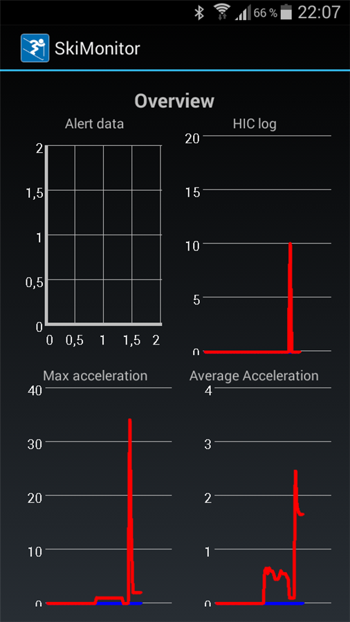

In a totally unscientific comparison I also measured what happens when the SkiMon device is dropped on its own:
Surprisingly the acceleration forces are much smaller - most probably because the mass of the device is so much smaller than that of the helmet. For a better evaluation I would need to strap it on e.g. a melon, both with and without the helmet and compare these situations.
