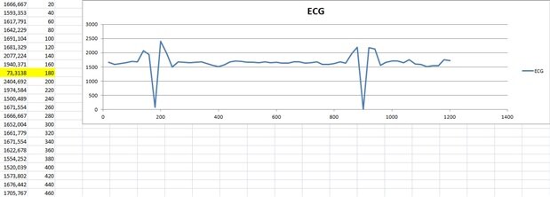

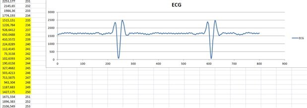

The next two pictures is showing a typical ECG signal. The only difference is the sampling time: 1 ms and 20 ms. Seen that the chamfer line fast enough. This is important because the pulse measurement is based on the cycle length.
In both cases, indicated by yellow background if the measured voltage of output of AD8232-EVALZ is lower than 1,6 V. 16 vs 1. Hmmmm...

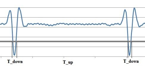

The method of pulse measurement is the following:
1. Measure the ECG signal (blue line).
2. Predefine the threshold voltage (gray line).
3. If the measured signal is lower than the threshold voltage, the T_down is counted.
4. If the measured signal is higher than the threshold voltage, the T_up is counted.
Using the simplification that:
(a) the signal of under the limit is symmetrical,
(b) the minimum point is where T_down/2,
(c) all shape is similar T_down1 = T_down2 = T_down.
5. The cycle time is: T_down/2 + T_up + T_down/2 = T_down + T_up.
