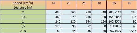

The reaction time depends on two factors, as shown in the table below:
The table shows that how much time (millisec) is needed to the system be activated within given speed and given distance. This can be interesting if we go into a dark tunnel.
