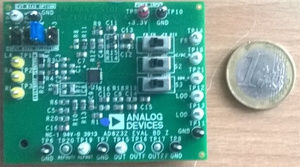

1. AD8232-EVALZ

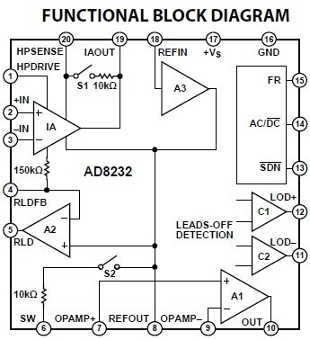

This is a single-lead, heart rate monitor front end is based on AD8232 chip. The functional block diagram is seen below. The measured bioelectric signals are sensed via attached electrodes on the human body. This device can operate with 2 (left, right) or 3 (left, right and driven) electrodes. The two (L and R) electrodes connect to the instrumental amplifier (IA), which is consists of the listened parts:
  • RFI filter,
  • Well-matched transconductance amplifiers,
  • DC blocking amplifier,
  • Integrator.
The operational amplifier (A1) is a general-purpose, rail-to-rail device for additional gain and low-pass filtering.
The right leg drive amplifier (A2) inverts the presented common-mode signal of input of IA. The injected current by the RLD output counteracts the common-mode voltage and improving the common-mode rejection of measuring system.
The midsupply reference buffer (A3) generates the virtual ground.
The leads of detection can be work in two modes:
DC: only works with three electrodes configuration. This indicates that which electrode has fallen off.
AC: can be used for two electrodes configuration. This marks only the fact of falling.
The fast restore function (FR) reduces the duration of otherwise long settling tails of the high-pass filters.
The AD8232 can be used for several applications, like heart rate measurement or cardiac monitor.

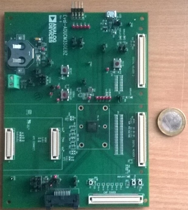

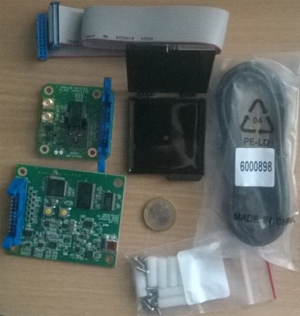

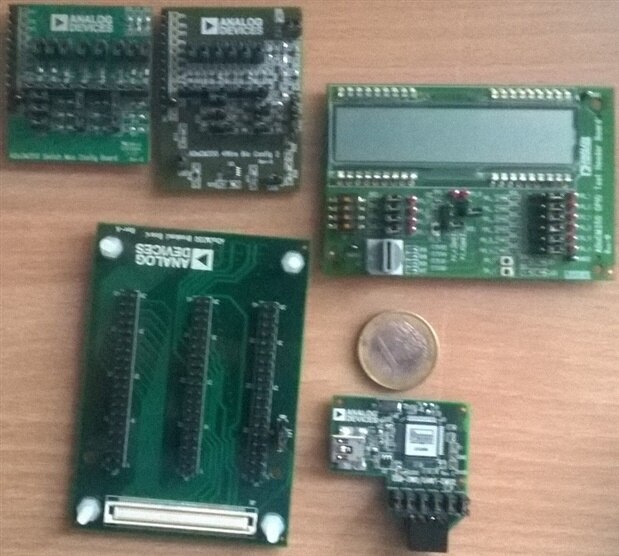

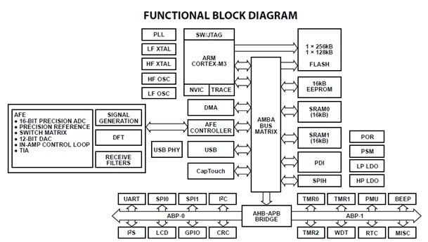

2. ADuCM350EBZ Evaluation Board Development Kit
This is an ARM Cortex-M3 based microprocessor with 16 MHz clock speed. It has got 32 KB of SRAM, 16 KB of flash and 384 KB of embedded flash memory. It has 12-bit DAC and 16-bit ADC with 160 kSPS. It is designed for capabilities of amperometric, voltametric and impedometric measurement. There are three way to supply the board: via USB port, CR2032 battery or external supply (2,5-3,6 V).
The Development Kit contains the following items:
  • main (mother) board
  • J-Link emulator (USB-SWD/UART)
  • AFE board
  • Break out board
  • GPIO test header board

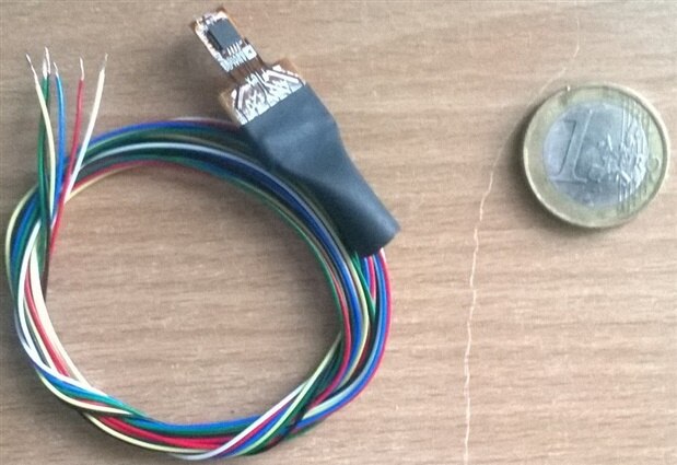

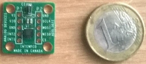

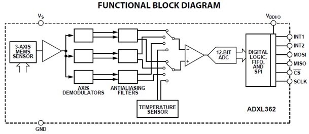

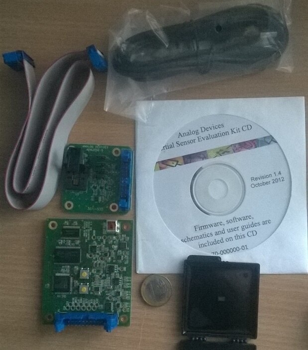

4. Based on the ADXL362 chip, the following items are provided:

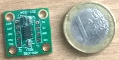

            a. EVAL-ADXL362Z: It is a 3-axis digital accelerometer board with different, ± 2g, ± 4g and ± 8 g of measurement ranges. It operates in two modes: the first is the measurement mode with less then 3 μA and data rate between 12,5 and 400 Hz, the others is the wake up mode with 270 nA consumption. The output has 12-bit resolution via SPI protocol.
            b. EVAL-ADXL362Z-MLP: It is a complete system for real-time evaluation of the accelerometer. It has a graphical user interface (GUI) to evaluate the parameters, for example power consumption, temperature coefficient and noise. The system consists of a motherboard and a satellite board.

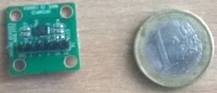

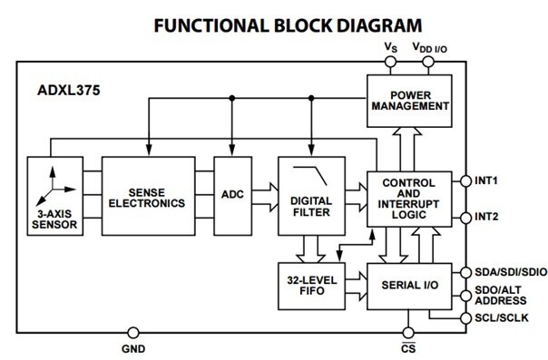

5. Based on the ADXL375 chip, the following items are provided:
            a. EVAL-ADXL375Z: It is a 3-axis digital accelerometer board ± 200 g of measurement ranges. This board is ideal for shock detection with high range of survival (10 000 g). The output has 16-bit two complement data via SPI (3- or 4-wire) or I2C protocol.
            b. EVAL-ADXL375Z-M: It is a evaluation system of 3-axis digital accelerometer with high resolution (13-bit) measurement up ± 200 g. The system consists of main board and a satellite board.

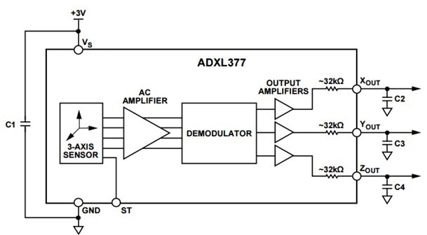

6. EVAL-ADXL377Z
It is a 3-axis, analog accelerometer with ± 200 g of measurement range. The analog outputs of ADXL362/375/377Z are ratiometric: that means that 0 g measurement output is always at half of the 3,3 V output (1.65 V), negative lower limit is at 0 V and positive higher limit is at 3,3 V with full scaling in between. The board is ideal for shock detection with high range of survival (10 000 g), therefore it is the basis of head impact monitor section.

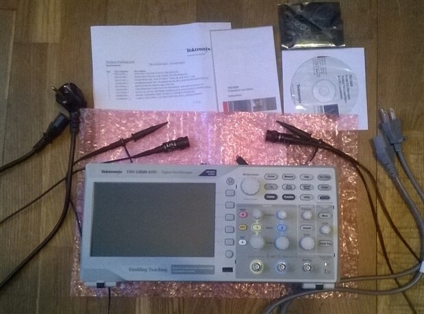

7. Tektronix TBS 1202B-EDU
The provided oscilloscope is a digital model with 7'' WVGA TFT color display, 200 MHz bandwidth and 2 GS/s sample rate on 2 channels. It has a Courseware feature that is ideal for the teaching (this feature not been used during the design). The UK type plugin cable was included, nevertheless it was not problem, because a needed European cable was available at home.

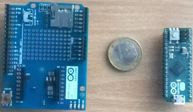

Arduino:
Compared to the other Arduino boards, the Arduino Micro was the best choice for the smart clothes. It is based on the 8-bit ATmega32u4 microcontroller with 16 MHz clock speed. It has 12 analog inputs and 20 digital input/output pins of which 7 can be used for pulse-width modulation (PWM) outputs. After the filtering, the PWM output can be operated as analog output. The amount of available memory is 32 KB. It is a well-equipped devices with tiny size: 17,8·48,3mm. Comparing the size of SD card logger to Arduino Micro, I used the SD card instead of the SD card logger board.

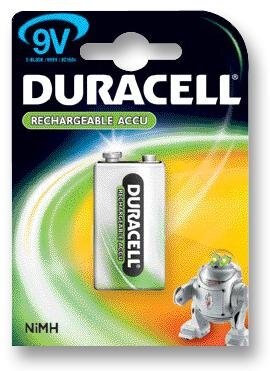

Batteries:
Because of the sustainable development and green aspects I decided to use rechargeable batteries for the power supply. Types of AA and PP3 were used.

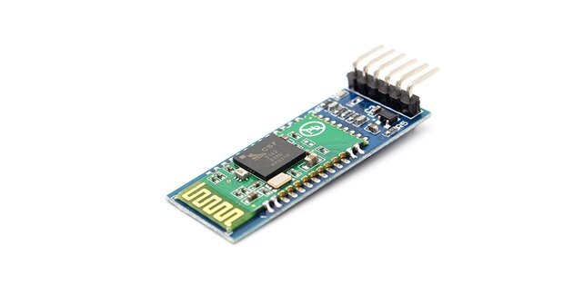

Bluetooth module:
JY-MCU Bluetooth module are the selected device for the wireless communication between the developed system and smart phone.

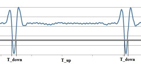

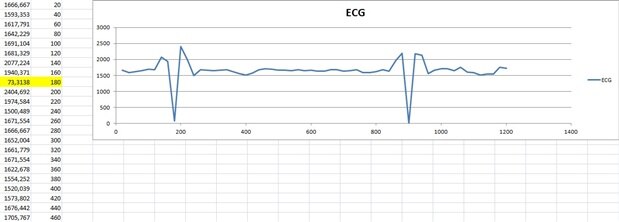

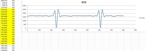

The next two pictures is showing a typical ECG signal. The only difference is the sampling time: 1 ms and 20 ms. Seen that the chamfer line fast enough. This is important because the pulse measurement is based on the cycle length.
In both cases, indicated by yellow background if the measured voltage of output of AD8232-EVALZ is lower than 1,6 V. 16 vs 1 - hmmmm...
The method of pulse measurement is the following:
1. Measure the ECG signal (blue line).
2. Predefine the threshold voltage (gray line).
3. If the measured signal is lower than the threshold voltage, the T_down is counted.
4. If the measured signal is higher than the threshold voltage, the T_up is counted.
Using the simplification that
a)      the signal of under the limit is symmetrical and
b)      the minimum point is where T_down/2 and
c)      all shape is similar T_down1 = T_down2 = T_down.
5. The cycle time is: T_down/2 + T_up + T_down/2 = T_down + T_up.

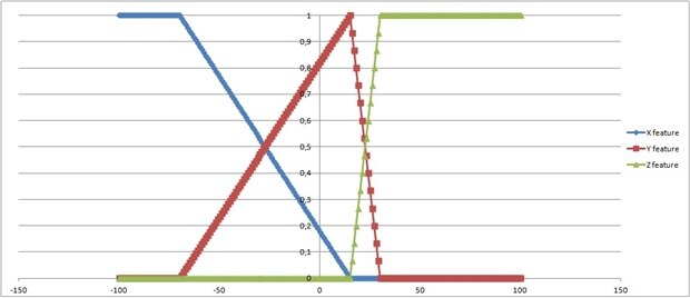

The main feature of my project is the Fuzzy logic based visibility system. What is the Fuzzy logic? In contrast to the binary (yes-no) logic, there is not sharp boundaries in the Fuzzy logic. A typical fuzzy sets shown below:
There is a variable (e.g. temperature, deflection, illumination, etc.) and several (here three) sets. Each input case has a probability the extent to which a member of the set. For example, if the input is -50, it means that the input belongs to 76,5% of X feature and 23,5% of Y feature. In any case, the sum of the probability is exactly 100%.
In the case of designed system, the variable is the resistance of LDRs (~illumination), and there are 3 features: light, transition and dark. The output is set by experimental measurements.

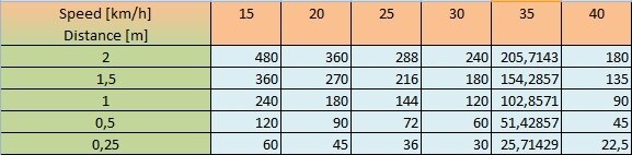

The reaction time depends on two factors, as shown in the table below:
The table shows that how much time (millisec) is needed to the system be activated within given speed and given distance. This can be interesting if we go into a dark tunnel.
