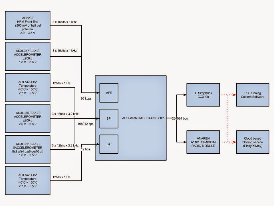

Looking over the system there was a clear need for a single wireless connection that could handle all the data. A quick calculation was done to determine what bandwidth was needed in order to allow for a better choice of wireless protocol.
Figure 1. Data Flow & Data Rates as Data Moves through the System
At the above calculated data rate of 264 kbps there was no real choice other than WiFi. While for a single player or even two players other options may be possible, for a full team the data rate quickly climbs above 1Mbps and only WiFi has a practical data rate above 3Mbps. While in theory the WiFi can handle the data rates for a team of players it is unclear at this point if the range needed to cover a hockey rink is possible. As the design moves forward this will be tested and hopefully resolved.
