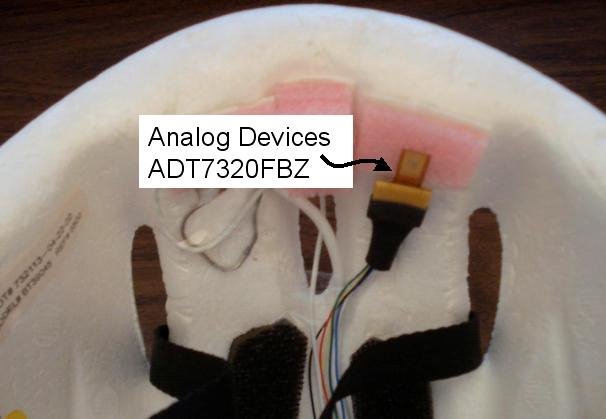

Here is another update on my "Wearable Sudden Impact and Health Monitor" project.
In this update I will show how I added a measurement feature for body temperature.
The body temperature is measured using the Analog Devices ADT7320, which is very small (4mm x 4mm) and it is mounted on the front inside the helmet, so that it touches the forehead.  To ensure good contact with the skin, the ADT7320 sensor is placed on a layer of elastic sponge-type material.  This implementation can be seen in the figure below:
