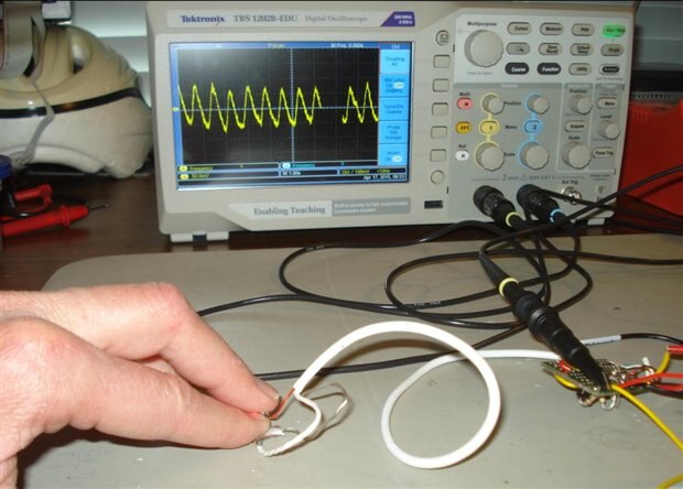

I implemented the schematic shown above using a solder prototype board and I then compared the measurements using the transmittance pulse oximetry on a finger and the reflectance pulse oximetry on my forehead.  The picture below shows the amplifier output signal of the transmittance method measured with the Tektronix 1202B-EDU oscilloscope.

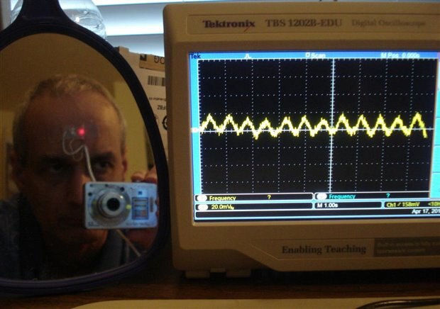

The signal contains the amplitude modulation generated by the heart rate.  The prototype board can be seen on the right side of the picture, where the oscilloscope probe connects.  Next I placed the LEDs and PIN photodiode on my forerhead and I measured the same signal at the output of the front end amplifier, as shown in the picture below.
