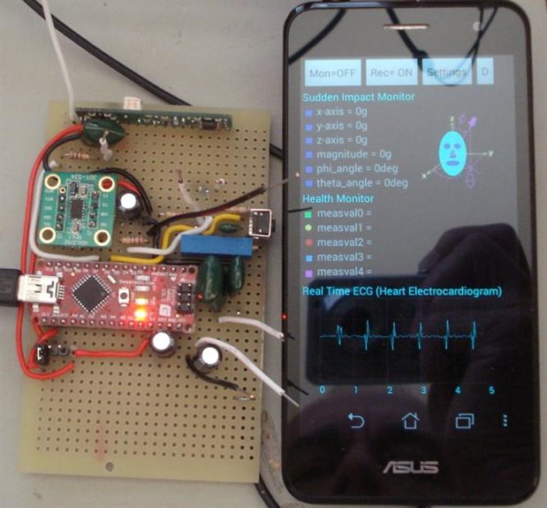

I am back with another update on my "Wearable Sudden Impact and Health Monitor" project.
In my previous update I showed how I improved my Android app by adding a graph that will display the real time ECG measurement.   That time the graph was functional but the hardware and firmware for capturing the ECG was not done yet.
So I started to experiment with the Analog Devices AD8232 evaluation board, which I found extremely easy to setup and use.  In only a few minutes I had a ECG signal displayed on the Tektronix TBS 1202B-EDU oscilloscope.  Here is a picture of this experiment.
The blue wires connect to the electrodes placed on my chest.  Based on this experiment I selected the location of the electrodes.  My next step was to capture the ECG and send it to the Android app running on my cell phone.  I spent some time getting this to work, but I am happy to see it functional now.  Here is a picture of the ECG displayed on my cell phone.
My next step will be to write a function that measures the heart rate from the ECG signal.
This is where I got so far with my wearable impact and health monitor system.  I will come back with other updates as I get more work done.

    ciorga over 11 years ago in reply to gadget.iom +1
    Thank you for the nice comment Paul; yes, it took me quite some effort to capture and send the ECG to the Android app, but I am happy to see it working. Best Wishes, Cosmin

  • gadget.iom
    gadget.iom over 11 years ago
    Coming together nicely. That ECG display looks great!
