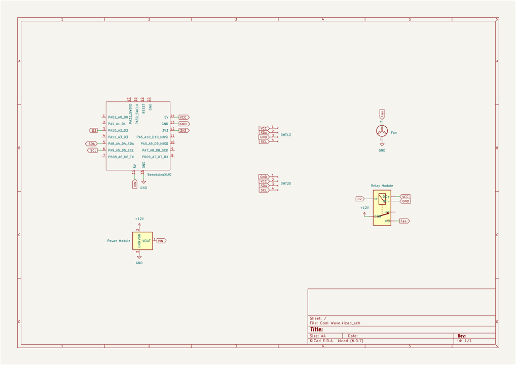

The Schematic of the Cool Wave project
One thing to note is that the electronics for Cool Wave are intentionally and unapologetically simple. One of the driving factors of the Cool Wave design is for it to be used by, modified by and improved by non-engineers. Very much like the ethos behind the original Arduino design. I can not create a solution for every eventuality, but I can create something that can be modified by most people to fit their needs.

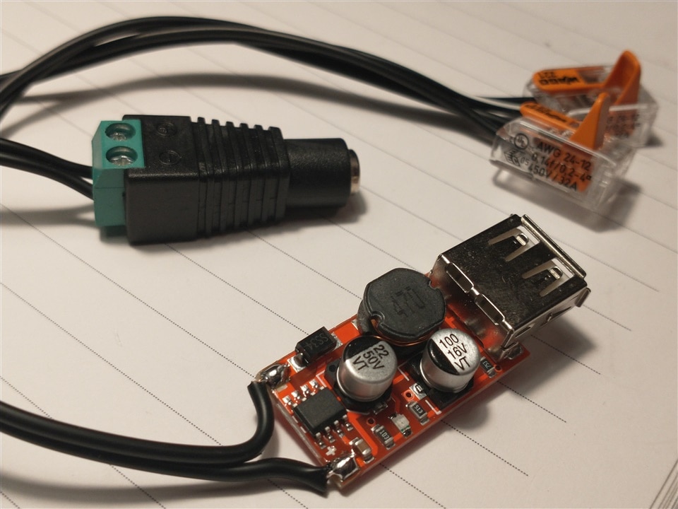

Power Supply
Connectors and power suply
The main power will come from a “wall wart” that is the same voltage as required by the fan. In this case that is 12v. In the photograph is a female power connector to screw terminal adapter and these are a really useful thing to have lying around. I use them all the time and it is an easy way of extending a wall wart power supply cable.
The incoming power cable will terminate at some Wago connectors that will connect to the fan and a buck converter for the rest of the electronics.
Because of the drop in voltage from 12v to the 5v needed to power the rest of the electronics, a simple power regulator is not appropriate. More power will be wasted as heat than used. The good news is that a DC to DC buck converter (photographed) is low cost and efficient. We could use one that is soldered directly onto the microcontroller, but I have chosen to use a USB C cable to allow easy testing and reprogramming.

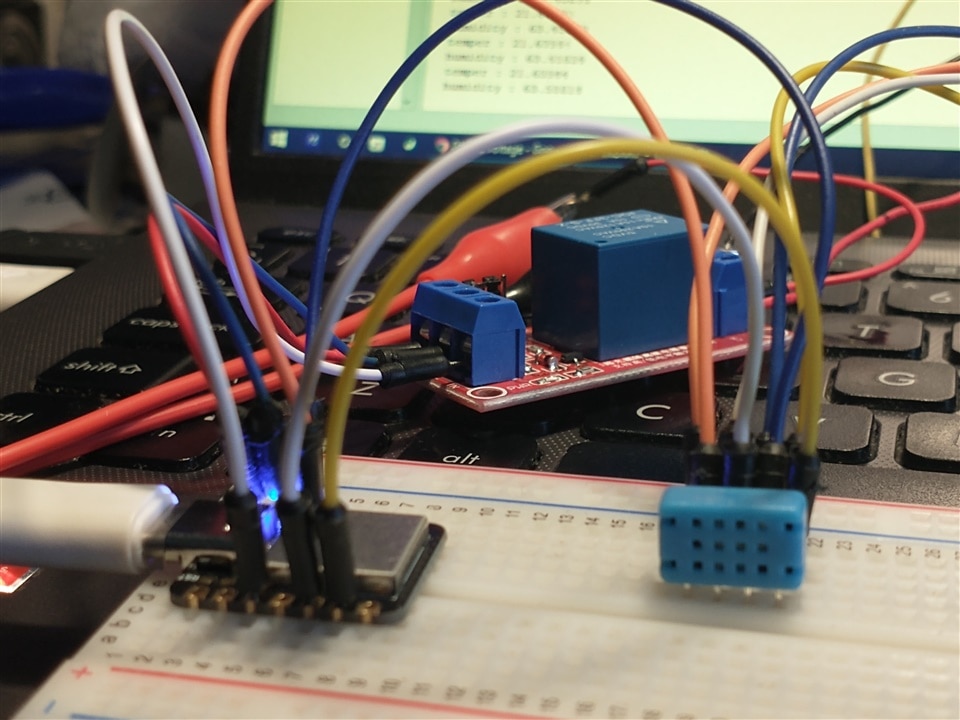

Putting it all together
Some components connected up
All this will be soldered together and later mounted in an appropriate enclosure, but for the moment I am going to use a breadboard to test everything together first. That said, if I exclusively use Seeed Studio Grove sensors then no soldering would be required.
I will go over the assembly in more detail in the next blog post when I do the physical and final build, but here is a video of the system working. I am testing with some early stage code and a hairdryer to apply heat.
